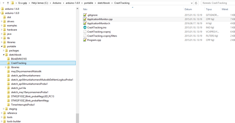

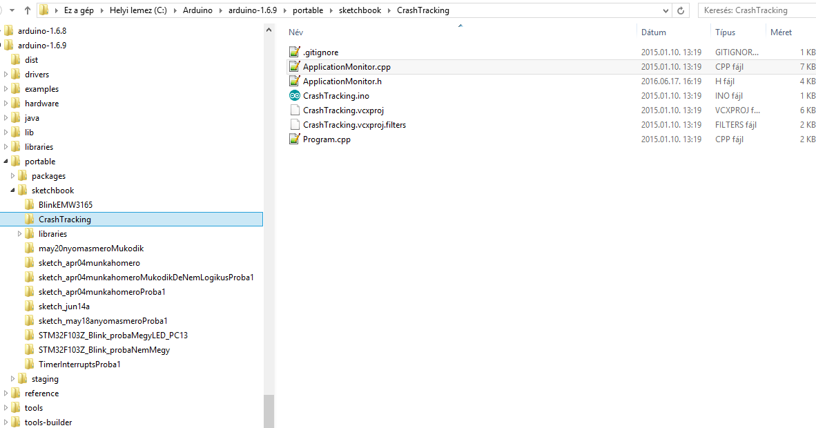

Nálad valahogy nem jó ez a fájl. -
Teasüti
Janos250
#3201
A panel típusát nem szoktam piszkálni, telepítés után egyszer be lett állítva, aztán ennyi.
Háát, van itt baj rendesen, ha érti vki mi a hiszti:Arduino: 1.6.8 (Windows 10), Alaplap:"Arduino/Genuino Uno"
In file included from C:\Users\cex\Documents\Arduino\kicsike\kicsike.ino:1:0:
C:\Users\cex\Documents\Arduino\libraries\AppMonitor/ApplicationMonitor.h:26:5: error: stray '\302' in program
<title>ArduinoCrashMonitor/ApplicationMonitor.h at master · Megunolink/ArduinoCrashMonitor · GitHub</title>
C:\Users\cex\Documents\Arduino\libraries\AppMonitor/ApplicationMonitor.h:26:5: error: stray '\267' in program
C:\Users\cex\Documents\Arduino\libraries\AppMonitor/ApplicationMonitor.h:138:3: error: missing terminating ' character
<!-- </textarea> --><!-- '"` --><form accept-charset="UTF-8" action="/Megunolink/ArduinoCrashMonitor/search" class="js-site-search-form" data-scoped-search-url="/Megunolink/ArduinoCrashMonitor/search" data-unscoped-search-url="/search" method="get"><div style="margin:0;padding:0;display:inline"><input name="utf8" type="hidden" value="✓" /></div>
C:\Users\cex\Documents\Arduino\libraries\AppMonitor/ApplicationMonitor.h:467:69: error: stray '#' in program
<td id="LC8" class="blob-code blob-code-inner js-file-line">#<span class="pl-k">pragma</span> once</td>
C:\Users\cex\Documents\Arduino\libraries\AppMonitor/ApplicationMonitor.h:471:69: error: stray '#' in program
<td id="LC9" class="blob-code blob-code-inner js-file-line">#<span class="pl-k">include</span> <span class="pl-s"><span class="pl-pds"><</span>Arduino.h<span class="pl-pds">></span></span></td>
C:\Users\cex\Documents\Arduino\libraries\AppMonitor/ApplicationMonitor.h:475:70: error: stray '#' in program
<td id="LC10" class="blob-code blob-code-inner js-file-line">#<span class="pl-k">include</span> <span class="pl-s"><span class="pl-pds"><</span>avr/wdt.h<span class="pl-pds">></span></span></td>
C:\Users\cex\Documents\Arduino\libraries\AppMonitor/ApplicationMonitor.h:492:70: error: stray '#' in program
<td id="LC14" class="blob-code blob-code-inner js-file-line">#<span class="pl-k">if</span> defined(__AVR_ATmega2560__)</td>
C:\Users\cex\Documents\Arduino\libraries\AppMonitor/ApplicationMonitor.h:496:70: error: stray '#' in program
<td id="LC15" class="blob-code blob-code-inner js-file-line">#<span class="pl-k">define</span> <span class="pl-en">PROGRAM_COUNTER_SIZE</span> <span class="pl-c1">3</span> <span class="pl-c">/* bytes*/</span></td>
C:\Users\cex\Documents\Arduino\libraries\AppMonitor/ApplicationMonitor.h:500:70: error: stray '#' in program
<td id="LC16" class="blob-code blob-code-inner js-file-line">#<span class="pl-k">else</span></td>
C:\Users\cex\Documents\Arduino\libraries\AppMonitor/ApplicationMonitor.h:504:70: error: stray '#' in program
<td id="LC17" class="blob-code blob-code-inner js-file-line">#<span class="pl-k">define</span> <span class="pl-en">PROGRAM_COUNTER_SIZE</span> <span class="pl-c1">2</span> <span class="pl-c">/* bytes*/</span></td>
C:\Users\cex\Documents\Arduino\libraries\AppMonitor/ApplicationMonitor.h:508:70: error: stray '#' in program
<td id="LC18" class="blob-code blob-code-inner js-file-line">#<span class="pl-k">endif</span></td>
C:\Users\cex\Documents\Arduino\libraries\AppMonitor/ApplicationMonitor.h:718:70: error: stray '#' in program
<td id="LC68" class="blob-code blob-code-inner js-file-line">#<span class="pl-k">if</span> defined(WDTO_4S)</td>
C:\Users\cex\Documents\Arduino\libraries\AppMonitor/ApplicationMonitor.h:726:70: error: stray '#' in program
<td id="LC70" class="blob-code blob-code-inner js-file-line">#<span class="pl-k">endif</span></td>
C:\Users\cex\Documents\Arduino\libraries\AppMonitor/ApplicationMonitor.h:730:70: error: stray '#' in program
<td id="LC71" class="blob-code blob-code-inner js-file-line">#<span class="pl-k">if</span> defined(WDTO_8S)</td>
C:\Users\cex\Documents\Arduino\libraries\AppMonitor/ApplicationMonitor.h:738:70: error: stray '#' in program
<td id="LC73" class="blob-code blob-code-inner js-file-line">#<span class="pl-k">endif</span></td>
C:\Users\cex\Documents\Arduino\libraries\AppMonitor/ApplicationMonitor.h:873:3: error: missing terminating ' character
<!-- </textarea> --><!-- '"` --><form accept-charset="UTF-8" action="" class="js-jump-to-line-form" method="get"><div style="margin:0;padding:0;display:inline"><input name="utf8" type="hidden" value="✓" /></div>
C:\Users\cex\Documents\Arduino\libraries\AppMonitor/ApplicationMonitor.h:5:1: error: expected unqualified-id before '<' token
<!DOCTYPE html>
C:\Users\cex\Documents\Arduino\libraries\AppMonitor/ApplicationMonitor.h:471:148: error: expected unqualified-id before '<' token
C:\Users\cex\Documents\Arduino\libraries\AppMonitor/ApplicationMonitor.h:471:189: error: expected unqualified-id before '<' token
C:\Users\cex\Documents\Arduino\libraries\AppMonitor/ApplicationMonitor.h:475:149: error: expected unqualified-id before '<' token
C:\Users\cex\Documents\Arduino\libraries\AppMonitor/ApplicationMonitor.h:475:190: error: expected unqualified-id before '<' token
In file included from C:\Users\cex\Documents\Arduino\kicsike\kicsike.ino:3:0:
C:\Users\cex\Documents\Arduino\libraries\FAB_LED-master/FAB_LED.h:28:29: error: expected declaration before end of line
#pragma GCC optimize ("-O2")
exit status 1
Error compiling for board Arduino/Genuino Uno.
This report would have more information with
"Show verbose output during compilation"
option enabled in File -> Preferences.
