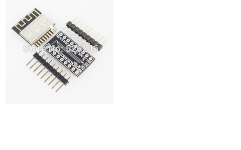

A kolléga ma ezeket mutatta, lehet halmozok kicsit
:https://www.aliexpress.com/item/33051277160.html?spm=a2g0o.cart.0.0.8da73c00hEeqI4&mp=1
https://www.aliexpress.com/item/32849927022.html?spm=a2g0o.cart.0.0.3f5a3c00k7ygLW&mp=1
