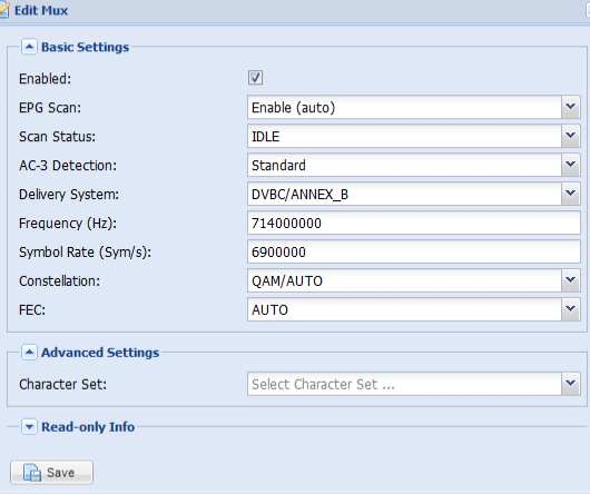

Közben lett egy kis változás (csináltam egy apt update && apt upgrade && rpi-update-et).
Mennyiségre való tekintettel pastebinre raktam: [link].Próbáltam QAM/256-ra is (TV-n az volt), és semmi
Szerk.: Esetleg megpróbálok minden értéket megadni a MUXnál tvheadendbe. FEC értéke mi szokott lenni?

Ja, meg a Tvheadend start után:
Jun 13 16:43:28 raspberrypi tvheadend[757]: START: HTS Tvheadend version 4.0.8~jessie started, running as PID:757 UID:109 GID:44, CWD:/ CNF:/home/hts/.hts/tvheadend
Jun 13 16:43:28 raspberrypi tvheadend[757]: mpegts: 714MHz in Teszt - tuning on Silicon Labs Si2168 : DVB-C #0
Jun 13 16:43:28 raspberrypi tvheadend[757]: linuxdvb: Silicon Labs Si2168 : DVB-C #0 - failed to tune [e=Érvénytelen argumentum]Ez utolsót nem tudom mire vélni...

Igen, Raspbian, 4.0.8-as tvheadend, repóból felrakva
dmesg végéről a releváns dolgok:
[ 10.756110] dvb-usb: found a 'Mygica T230 DVB-T/T2/C' in warm state.
[ 11.004069] dvb-usb: will pass the complete MPEG2 transport stream to the software demuxer.
[ 11.004320] DVB: registering new adapter (Mygica T230 DVB-T/T2/C)
[ 11.058720] si2168 3-0064: Silicon Labs Si2168 successfully attached
[ 11.105967] si2157 4-0060: Silicon Labs Si2147/2148/2157/2158 successfully attached
[ 11.106103] usb 1-1.3: DVB: registering adapter 0 frontend 0 (Silicon Labs Si2168)...
[ 11.107250] dvb-usb: schedule remote query interval to 100 msecs.
[ 11.107375] dvb-usb: Mygica T230 DVB-T/T2/C successfully initialized and connected.
[ 11.107638] usbcore: registered new interface driver dvb_usb_cxusb
[ 13.469897] si2168 3-0064: found a 'Silicon Labs Si2168-B40'
[ 13.472618] si2168 3-0064: downloading firmware from file 'dvb-demod-si2168-b40-01.fw'
[ 14.364642] si2168 3-0064: firmware version: 4.0.11
[ 14.377967] si2157 4-0060: found a 'Silicon Labs Si2158-A20'
[ 14.379355] si2157 4-0060: downloading firmware from file 'dvb-tuner-si2158-a20-01.fw'
[ 15.851228] si2157 4-0060: firmware version: 2.1.9
[ 20.278289] usb 1-1.3: DVB: adapter 0 frontend 0 frequency 0 out of range (55000000..862000000)Ergo a verziók is jók, mégis:
ERROR: Sorry - i couldn't get any working frequency/transponder
Nothing to scan!!Most itt leszek a gép előtt egy jó darabig, tudok azonnal válaszolni, hátha találunk valami megoldást
azbest
LógaGéza
#21443
raspbian alól van ez most?
dmesg alól nézd meg, hogy milyen verziót tölt be
[ 48.031022] si2168 3-0064: downloading firmware from file 'dvb-demod-si2168-b40-01.fw'
[ 48.773973] si2168 3-0064: firmware version: 4.0.11
[ 48.784505] si2157 4-0060: found a 'Silicon Labs Si2158-A20'
[ 48.785682] si2157 4-0060: downloading firmware from file 'dvb-tuner-si2158-a20-01.fw'
[ 50.034758] si2157 4-0060: firmware version: 2.1.9A 4.0.19 nem jó. A 4.0.11 vagy 4.0.4 a jó az si2168-hez. A fenti idézetben a legfrisebb állapot van, pár hónapja még 4.0.19 volt benne, de jelezték neki, hogy az rossz és átcserélték.
Az openelec/libraelec firmware repóból lehet ezeket megszerezni könnyen. Ha jól olvastam akkor a hibás firmware is okozhatja a beragadást (hogy ugyanaz jön mindenütt).Ha openelec-et próbálod, akkor próbáld indulás után utólag bedugni a tunert, ha nincs aktív hubod.
tvheadend-ből a v4.0.9 a legfrisebb stabil, amit múltkor tévedésből mondtam 4.1-est, az sokkal régebbi és hibázós.

Megjött a T230-as tuner, és próbálom beállítgatni.
A w_scan semmit nem talált, syslogba is ezt látom:Jun 12 20:37:46 raspberrypi tvheadend[463]: mpegts: 714MHz in Teszt - tuning on Silicon Labs Si2168 : DVB-C #0
Jun 12 20:37:46 raspberrypi tvheadend[463]: linuxdvb: Silicon Labs Si2168 : DVB-C #0 - failed to tune [e=Érvénytelen argumentum]1 MUXot vettem fel, az adatait egy működő TV-ről néztem le. Mondjuk egyiken 6900000 a Symbol Rate, a másikon 6915000, de mindkettőn ugyanaz az adás van... Próbáltam már a 2014-07-18-as modullal, és a aktuális OpenELEC-essel, beraktam Azbest szkripjét is, mégsincs semmi...
Mit rontok el?
