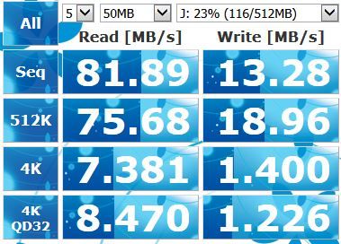

Beni2360
#20117
Hagyd csak Beni....
Én azért futtattam a PI-n (SanDisk ultra):
# hdparm -tT /dev/mmcblk0p1
/dev/mmcblk0p1:
Timing cached reads: 524 MB in 2.00 seconds = 261.44 MB/sec
Timing buffered disk reads: 60 MB in 2.83 second = 21.23 MB/secÜdvözlettel,
Gábor -
