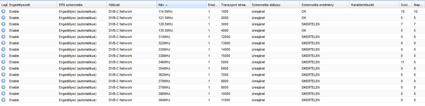

Vettem egy MyGica T230C USB-s DVB-C Tunert a RPi 2-höz, de nem igazán találja a muxokat.
LibreELEC verzió: 8.2.5A logban sem látok semmi hibára utaló jelet:
P-libreelec:/ # dmesg | grep dvb
[ 4.593327] dvb-usb: found a 'Mygica T230C2 DVB-T/T2/C' in warm state.
[ 4.836588] dvb-usb: will pass the complete MPEG2 transport stream to the software demuxer.
[ 4.836813] dvbdev: DVB: registering new adapter (Mygica T230C2 DVB-T/T2/C)
[ 5.035662] dvb-usb: schedule remote query interval to 100 msecs.
[ 5.036551] dvb-usb: Mygica T230C2 DVB-T/T2/C successfully initialized and connected.
[ 5.036774] usbcore: registered new interface driver dvb_usb_cxusb
[ 7.982191] si2168 3-0064: downloading firmware from file 'dvb-demod-si2168-d60-01.fw'
[ 8.436448] si2157 4-0060: downloading firmware from file 'dvb-tuner-si2141-a10-01.fw'
P-libreelec:/ # dmesg | grep si2168
[ 4.901177] si2168 3-0064: Silicon Labs Si2168-D60 successfully identified
[ 4.901189] si2168 3-0064: firmware version: D 6.0.1
[ 8.395878] si2168 3-0064: firmware version: D 6.0.2
P-libreelec:/ # dmesg | grep si2157
[ 4.946940] si2157 4-0060: Silicon Labs Si2141/2151 successfully attached
[ 8.422841] si2157 4-0060: found a 'Silicon Labs Si2141-A10'
[ 8.913554] si2157 4-0060: firmware version: 1.1.10Van csatorna amit megtalál, de aztán, ha nézni szeretném, No Signal hibaüzenetet kapok, pl. RTL Klub:
2168 #0 : DVB-C #0", network: "DVB-C Network", mux: "128.5MHz", provider: "Satelit Kft.", service: "RTL Klub", profile="htsp", hostname="127.0.0.1", username="x", client="Kodi Media Center"
2018-11-11 18:01:24.463 [ NOTICE] subscription: 002A: No input source available for subscription "127.0.0.1 [ x| Kodi Media Center ]" to channel "RTL Klub"
2018-11-11 18:01:26.463 [ NOTICE] subscription: 002A: No input source available for subscription "127.0.0.1 [ x| Kodi Media Center ]" to channel "RTL Klub"
2018-11-11 18:01:28.463 [ NOTICE] subscription: 002A: No input source available for subscription "127.0.0.1 [ x| Kodi Media Center ]" to channel "RTL Klub"
2018-11-11 18:01:30.463 [ NOTICE] subscription: 002A: No input source available for subscription "127.0.0.1 [ x| Kodi Media Center ]" to channel "RTL Klub"
2018-11-11 18:01:32.463 [ NOTICE] subscription: 002A: No input source available for subscription "127.0.0.1 [ x| Kodi Media Center ]" to channel "RTL Klub"
2018-11-11 18:01:33.498 [ INFO] subscription: 002A: "127.0.0.1 [ x| Kodi Media Center ]" unsubscribing from "RTL Klub", hostname="127.0.0.1", username="x", client="Kodi Media Center"Kevés hiba látszik az állapot fülön:
A muxok beállításait ellenőriztem, ezek megfelelnek a szolgáltató által megadott értékeknek.
Lehet ezen javítani, vagy inkább vegyek egy set-top boxot?
Előre is köszönöm a segítségeteket!
