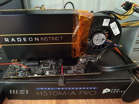

Temp at the turbine at 100% 63 ° C in the benchmark.
In games at the turbine at 50-60%, it does not go to 70 ° C and I have not replaced the paste yet.
Interestingly, the Dela turbine already had the same connector as in the GPU, but the wires were in a different order, it was enough to pull out and put them in the right one and it's ready. -

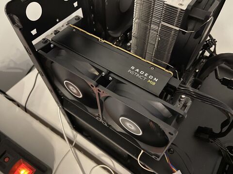

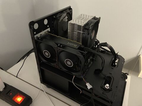

Czimby
As for the temperatures, I quickly got something like this:
As you can see in the photos, the housing is open, the temperature in the room is 22.4 degrees, the fans are set to 100%:
- max temp in tests - 70 degrees
- max temp in games - 54 degrees (fhd, forza 5 after 40 minutes of playing)
- max temp in tests after voltage changes - 65 degrees (settings someone threw here earlier)
- max temp in games after voltage changes - ran out of time. -

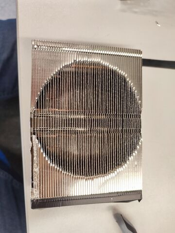

juliabrilke #239 üzenetére
A tölcsér miből készült?
Nagyon igényes! -

fatpingvin #254 üzenetére
Pontosítok: nyomtatáshoz az STL honnan?

rokapet
A tölcsér honnan, ha szabad kérdeznem?
Szerk.: #248-ra!
[link] -

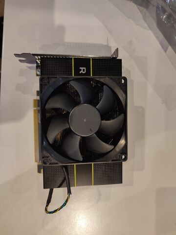

Martine
Steve_Brown #200 üzenetére
Mi is MX4-et használtunk daneg86-tal
90es ventit aplikáltunk rá, PWM 12V 0.5A.
Venti egy 3D Mark time spy teszt alatt 50 százalék fölé nem pörgött, kb 2k fordulattal, és 55-60 fokon volt a GPU. -
