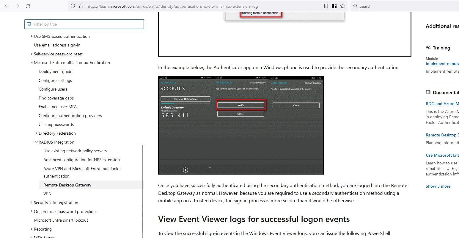

Friss MS doksi, benne Windows Phone-os authenticator
