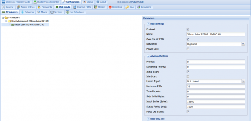

PI-n raspbiant használok:
root@rpi:/# uname -a
Linux rpi 4.1.7+ #817 PREEMPT Sat Sep 19 15:25:36 BST 2015 armv6l GNU/Linuxtvheadend:
root@rpi:/# tvheadend -v
tvheadend: version 0.0.0~unknownA tvheadend-et forrásból fordítottam, sajnos van benne az a bug, hogy ilyenkor 0.0.0 verziószámot ír ki
Emlékeim szerint 4.0 forrást töltöttem le a git-ből és azt fordítottam le. Az biztos, hogy tavaly június végén volt, azóta nem nyúltam hozzá.
A tuner driverről még egy kis dmesg info:
[ 9.513589] dvb-usb: found a 'Mygica T230 DVB-T/T2/C' in warm state.
[ 9.942378] dvb-usb: will pass the complete MPEG2 transport stream to the software demuxer.
[ 10.057033] DVB: registering new adapter (Mygica T230 DVB-T/T2/C)
[ 10.215222] i2c i2c-3: Added multiplexed i2c bus 4
[ 10.250602] si2168 3-0064: Silicon Labs Si2168 successfully attached
[ 10.399707] si2157 4-0060: Silicon Labs Si2147/2148/2157/2158 successfully attached
[ 10.472159] usb 1-1.2: DVB: registering adapter 0 frontend 0 (Silicon Labs Si2168)...
[ 10.540279] input: IR-receiver inside an USB DVB receiver as /devices/platform/soc/20980000.usb/usb1/1-1/1-1.2/input/input0
[ 10.597638] dvb-usb: schedule remote query interval to 100 msecs.
[ 10.630184] dvb-usb: Mygica T230 DVB-T/T2/C successfully initialized and connected.[ 32.348524] si2168 3-0064: found a 'Silicon Labs Si2168-B40'
[ 32.377950] si2168 3-0064: downloading firmware from file 'dvb-demod-si2168-b40-01.fw'
[ 33.004154] si2168 3-0064: firmware version: 4.0.4
[ 33.016531] si2157 4-0060: found a 'Silicon Labs Si2158-A20'
[ 33.042443] si2157 4-0060: downloading firmware from file 'dvb-tuner-si2158-a20-01.fw'
[ 34.201645] si2157 4-0060: firmware version: 2.1.6 -
