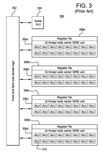

Bár lassan beilleszthetnénk a teljes szöveget de ez a szakasz is a teljesítményt taglalja:
In this example, therefore, the constant wavefront of a classical GPU architecture would be two threads. The classical GPU architecture would schedule the floating point multiplications over seven cycles across the two FPUs and would schedule the integer instructions over three cycles across the two IUs. So, the classical GPU architecture performs 14 threads of floating point work and six threads of integer work—wasted work for 13 and five threads worth of work, respectively.
Instead, for the floating point multiplication, six cycles×two FPUs and one cycle×one FPU may be scheduled, doing exactly 13 threads of work (the remaining FPU may be powered off, for instance). Similarly, for the integer addition, two cycles×two IUs and one cycle×one IU may be scheduled.
If execution resources R[t] of different types can cover certain computations, then the scheduler can schedule that computation over different heterogeneous resources. In the example above, if the FPUs were also able to execute integer operations (perhaps the IUs cannot execute floating point operations, however), then the extra integer operations available during the trailing cycle of the floating point operation could be used by the integer instructions, further increasing pipeline efficiency.
Finally, if these different types of units ran at different frequencies (or if they were on different voltage islands, allowing them to change voltage and frequency on demand), then it may be possible to schedule some threads on execution units running at different frequencies and with different thread widths, again potentially improving power efficiency. By utilizing the power saved by executing on lower-powered vector units, other vector units (perhaps those running more performance-critical threads) could be overclocked to yield higher overall program performance.

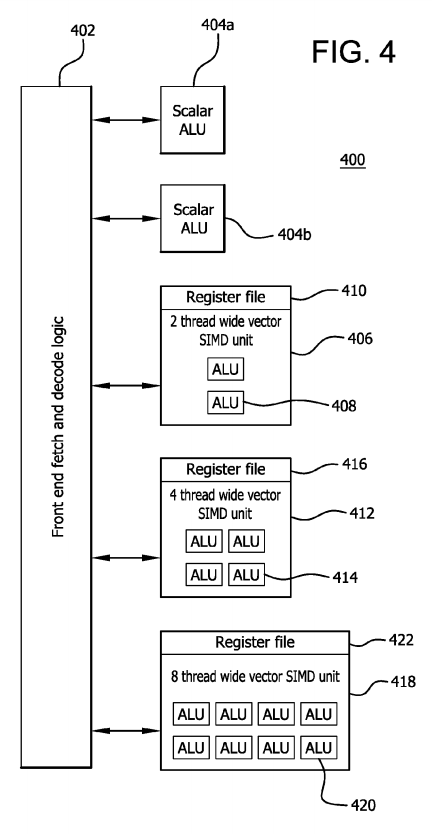

stratova #18941 üzenetére
Igen, értem, hogy mire megy ki a dolog, és tetszik is a megközelítés. Azt alapból is feltételeztem, hogy szélesebb wavefronthoz dinamikusan tudnak kombinálni unitokat. Ami nem áll össze, az az, hogy mi értelme lenne annak, hogy az összes SIMD unit pl. 8 széles, és ebből le van tiltva 4 vagy 6, hogy megkapjuk a 4-es és a 2-es vektorokat. Hacsak nem arra akartak utalni, hogy a fizikai méretek a 2-4-8, és ha pl. csupa 2-es wavefront repül, akkor tudják power gate-elni a 8-as és a 4-es unitokat - az úgy nyilván jó.
Mitől lesz egy skalár unit "high performance"? Nekem továbbra is úgy tűnik, hogy egy 1-széles vektorról van szó
stratova
[0031]-től kezdődik a magyarázat
By providing a set of execution resources within each GPU compute unit tailored to a range of execution profiles, the GPU can handle irregular workloads more efficiently. Current GPUs (for example, as shown in FIG. 3) only support a single uniform wavefront size (for example, logically supporting 64 thread wide vectors by piping threads through 16 thread wide vector units over four cycles). Vector units of varying widths (for example, as shown in FIG. 4) may be provided to service smaller wavefronts, such as by providing a four thread wide vector unit piped over four cycles to support a wavefront of 16 element vectors.
A +1 skalárhoz:
In addition, a high-performance scalar unit may be used to execute critical threads within kernels faster than possible in existing vector pipelines, by executing the same opcodes as the vector units. Such a high performance scalar unit may, in certain instances, allow for a laggard thread (as described above) to be accelerated. By dynamically issuing wavefronts to the execution unit best suited for their size and performance needs, better performance and/or energy efficiency than existing GPU architectures may be obtained.Példa:
In another example, assume that a wavefront includes 16 threads to be scheduled to a 16 thread wide SIMD unit, and only four of the threads are executing (the remaining 12 threads are not executing). So there are 12 threads doing “useless” work, but they are also filling up pipeline cycles, thereby wasting energy and power. By using smaller (and different) sizes of SIMD units (or vector pipelines), the wavefronts can be dynamically scheduled to the appropriate width SIMD units, and the other SIMD units may be powered off (e.g., power gated off or otherwise deactivated). By doing so, the saved power may be diverted to the active SIMD units to clock them at higher frequencies to boost their performance.Infó:
The smaller width SIMD units may be, for example, one, two, four, or eight threads wide. When a larger thread width SIMD unit is needed, any available smaller thread width SIMD units may be combined to achieve the same result. There is no performance penalty if, for example, the wavefront needs a 16 thread wide SIMD unit, but the hardware only includes smaller thread width SIMD units.In some embodiments, the collection of heterogeneous execution resources is shared among multiple dispatch engines within a compute unit. For instance, rather than having four 16 thread wide vector units, four dispatchers could feed three 16 thread wide vector units, four four thread wide vector units, and four high-performance scalar units. The dispatchers could arbitrate for these units based on their required issue demands.

stratova #18932 üzenetére
Persze, viszont eddig volt a széles SIMD meg a magányos skalár ALU. Most meg különböző szélességű SIMD-ek vannak, és ebben a nézetben a skalár ALU sem más, mint egy 1-széles vektor. Ráadásul nem is egy van belőle, hanem kettő.
A [0030] második felét nem nagyon értem, túl sok értelmét nem látnám annak, hogy 2db 8-széles SIMD-et lekasztráljanak 4, ill. 2 szélesre... Vagy mit akar itt mondani?

stratova
Ez ebben a formában igaz, de nekem úgy rémlik, hogy a legtöbb helyen jelzett core configban ált a SIMD blokkok vector ALU-it számolják és a teljesítmény is g/tflopsban adják meg, ahol az integer alu-t nem számolják bele.
Viszont magyarázat a lényeg:
[0028]
FIG. 4 is a block diagram of a portion of a compute unit (400) with different sizes of SIMD units. It is noted that the compute unit (400) includes various additional components not shown on FIG 4. FIG 4 only shows the portions of of the compute unit (400) relevant to understanding the concepts described herein.[0029]
The compute unit (400) includes a front end fetch and decode logic (402) and one or more arithmetic logic units (ALUs) (404a), (404b). The compute unit (400) also includes a number of different sizes of SIMD units. A two thread wide vector SIMD unit (406) includes two ALUs (408) and has an associated register file (410). A four thread wide vector SIMD unit (412) includes four ALUs (414) and has an associated register file (416). An eight thread wide vector SIMD unit (418) includes two ALUs (420) and has an associated register file (422).[0030]
It is noted that while the compute unit (400) is shown with two scalar ALUs (404) one two thread wide vector SIMD unit (406), one four thread wide vector SIMD unit (412), an one eight thread wide vector SIMD unit (418), the compute unit (400) may be constructed with different numbers of scalar units and the SIMD units without affecting the overall operation of the compute unit (400). Alternatively, SIMD units (406), (412) and (418) may initially have the same width (e.g., each being an eight thread wide SIMD unit) but may be configured (on a demand basis) to deactivate (e.g., gating mechanisms, disabling, powering off, etc.) to have different widths (e.g. a two thread wide, a four thread wide, an eight thread wide SIMD unit, as described above, by deactivating, six, four and zero, respectively, pipes or ALUs in each unit). -
Z10N
Igazad van, csak a hsz-t olvastam el, nem neztem meg a paten-t. Viszont ha a skalar is hozza van szamolva a korabbi CU-nal akkor meg 65 van
Ezekszerint az utemezesre es vezerlesre komoly hangsulyt fektettek. A hatekonysag pedig az asszimetrikus SIMD-ekbol szarmazhat. Atolvasom majd a folyamatabrakat es a leirast.
