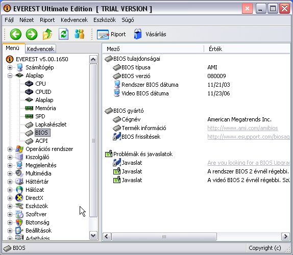

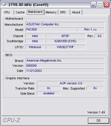

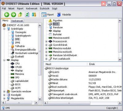

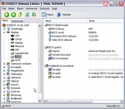

NEM TUDJA VALAKI, HOGY A BIOS VERZÍÓSZÁMÁT HOL TALÁLOM.
ASUS P4 C800 DELUXEAMIT TALÁLOK INDÍTÁSKOR ÉS EZZEL A PROGIVAL IS EZT ÍRJA KI
BIOS VER 0800009
KÖSZI -
