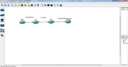

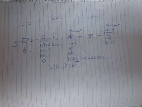

R1#terminal length 0
R1#
R1#
R1#
R1#
R1#sh run
Building configuration...Current configuration : 1606 bytes
version 12.4
service timestamps debug datetime msec
service timestamps log datetime msec
no service password-encryption
hostname R1
boot-start-marker
boot-end-marker
no aaa new-model
memory-size iomem 5
no ip icmp rate-limit unreachable
ip cef
no ip domain lookup
multilink bundle-name authenticated
archive
log config
hidekeys
crypto isakmp policy 1
encr aes
authentication pre-share
group 2
lifetime 200
crypto isakmp key cisco address 1.1.1.2
crypto ipsec transform-set ciscoset esp-aes esp-sha-hmac
crypto map CMAP 1 ipsec-isakmp
set peer 1.1.1.2
set transform-set ciscoset
set pfs group2
match address VPN
ip tcp synwait-time 5
interface FastEthernet0/0
ip address 1.1.1.1 255.255.255.0
ip nat outside
ip virtual-reassembly
speed 100
full-duplex
crypto map CMAP
interface FastEthernet0/1
ip address 192.168.0.1 255.255.255.0
ip nat inside
speed 100
full-duplex
ip forward-protocol nd
ip route 0.0.0.0 0.0.0.0 FastEthernet0/0
no ip http server
no ip http secure-server
ip nat inside source list NAT interface FastEthernet0/0 overload
ip access-list extended NAT
deny tcp 192.168.0.0 0.0.0.255 host 10.10.10.4 eq www
permit ip 192.168.0.0 0.0.0.255 any
ip access-list extended VPN
permit tcp 192.168.0.0 0.0.0.255 host 10.10.10.4 eq www
control-plane
line con 0
exec-timeout 0 0
privilege level 15
logging synchronous
line aux 0
exec-timeout 0 0
privilege level 15

R2#terminal length 0
R2#
R2#sh run
Building configuration...Current configuration : 1672 bytes
version 12.4
hostname R2
boot-start-marker
boot-end-marker
no aaa new-model
memory-size iomem 5
ip cef
no ip domain lookup
archive
log config
hidekeys
encr aes
group 2
lifetime 200
crypto isakmp key cisco address 1.1.1.1
set peer 1.1.1.1
set pfs group2
match address VPN
ip address 1.1.1.2 255.255.255.0
ip nat outside
speed 100
full-duplex
crypto map CMAP
ip address 10.10.10.2 255.255.255.0
ip nat inside
speed 100
full-duplex
no ip http server
ip nat inside source static tcp 1.1.1.2 80 10.10.10.4 80 extendable
deny tcp host 10.10.10.4 eq www 192.168.0.0 0.0.0.255
permit ip 10.10.10.0 0.0.0.255 any
permit tcp host 10.10.10.4 eq www 192.168.0.0 0.0.0.255
control-plane
line con 0
exec-timeout 0 0
privilege level 15
logging synchronous
line aux 0
exec-timeout 0 0
privilege level 15
logging synchronous
line vty 0 4
login
endR2#
Nemtudok amugysem aludni
tusi_
Meg annyit, az elso esetben ( portfw) a server publick natolt ipjet kell beirni a bongeszobe. Pl 1.1.1.1 ez lesz forwardolva a privatra.
A masodik, ipsec esetben a privatot, de kell egy zero nat is 😊 -
tusi_
tekintetes
#7832
Webserver elerese bal lanbol:
R2 (jobb oldali router)
Ip nat inside source static tcp public ip public port privat ip privat portIpsec:
2router kozott ipsec tunnel, interesting acl
R1:
Ip access list ext vpn-tunnel
Permit tcp bal lan subnet host server ip eq port number
R2:
Ip access list ext permit host server ip eq port bal lan subnetPontosan nemtudom mit jelent a "routereken nem mennek át."
tekintetes
Kaptam egy nekem igencsak bonyolult házi feladatot. Packet Tracer-ben kell megoldani, a mellékelt képen van.
A dhcp megvan, a két router között is mennek a csomagok, de a routereken nem mennek át.
A routerek alatt van, hogy miként kellene beállítanom. Tudna valaki segíteni ebben?
Megköszönném!
Skypon át tudom küldeni a pkt fájlt. (fekete.attila.age)BOLDOG KARÁCSONYT MINDENKINEK!

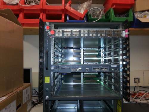

tusi_
Lesz meg egy doboz melle ugyanigy Supervisorral meg egy modullal a VSL-hez meg a Fast Hellohoz.
De lesz EPagP is, mert 1-2 ugyfelunknek a regi OS van, azt is be kell gyakorolni.
Aztan mennek ra a 3560-as Stackok...
Mar alig varom, hogy meglegyen a masik 720-as is es akkor mehet az ereszd el a hajam. Ember annyit meg nem tulorazott, amennyit en fogok.....
