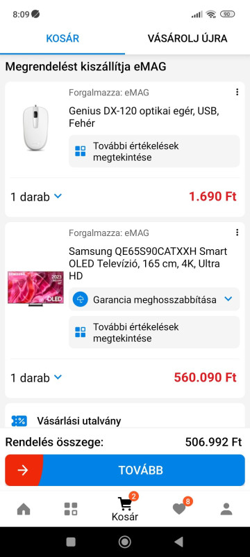

rainman72
Samu 65S90C kuponnal 507e eMag.
