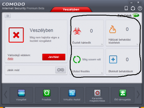

Felraktam a CIS 7 bétát Windows 8.1 re Virtualboxon,kissé visszalépésnek érzem a felületet a 6 os hoz képest.
A 6 os designosabb volt kissé..
Minek van kint a főlapon is az összegzés ha bővített nézetben is elérhető...
Teljesen felesleges.. -

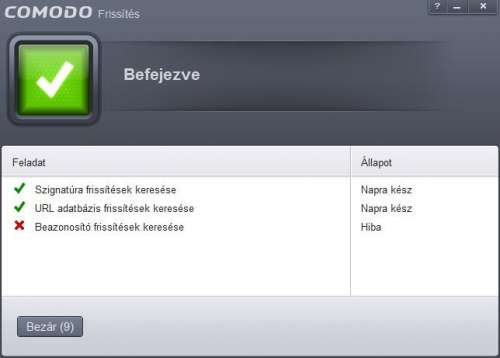

ÜDv, nemrég kezdtem tölteni, de bazi terhelt lehet a szerver mert lassan jön.

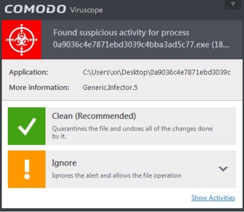

Még Viruscope:
Még egy kis leírás:
Viruscope monitors the activities of all processes, regardless of whether they are running normally or inside the sandbox. If suspicious activity is detected, Viruscope will generate a pop-up alert that allows you to block or allow the activity.
Enable Viruscope (Recommended) - Allows you to enable or disable Viruscope. If enabled, the Viruscope monitors the activities of all the running processes and generates alerts on suspicious activities. (Default = 'Enabled')
Do NOT show popup alerts - - Allows you to configure whether or not to show Viruscope alerts when a suspicious activity is recognized. Choosing 'Do not show popup alerts' will minimize disturbances but at some loss of user awareness. If you choose not to show alerts then you have a choice of default responses that CIS should automatically take - either 'Quarantine and Revert' or 'Ignore'. (Default = Disabled)
Quarantine and Revert - Moves the process and its parent application to quarantine and reverses the action that was taken by the process. (Default)
Ignore Once - The action will be allowed for one time. If the same activity is recognized again, an alert will be generated.pethYeti

Némi infó a viruscope-ról:
monitor following processes activities:
-copy self and add self to autorun in registry
-copy self to autorun path
-copy self and create link to self in autorun pathés
viruscope (VC) is in a very early stage. it uses "behavior recognizers" to detect malware but when adding more recognizers performance could drop so comodo is adding them with caution. the last we heard VC only detects when files copy themselves to the startup folder, add autorun reg key or create link of itself and add to startup folder. behavior recognizer updates will be pushed like signature and url filter updates.

Telepítve, eddig jó. A Viruscope-ot elolvastam, de nem teljesen világos mikor,
hogyan működik. Egy újabb felugró ablakkal lettünk gazdagabbak.
A fájl küldés persze még ebben sem működik. A skin viszont választható,
nem kötelező szerencsére a Metro dizájn. Túl nagy változások nincsenek,
ami inkább jó hír. -

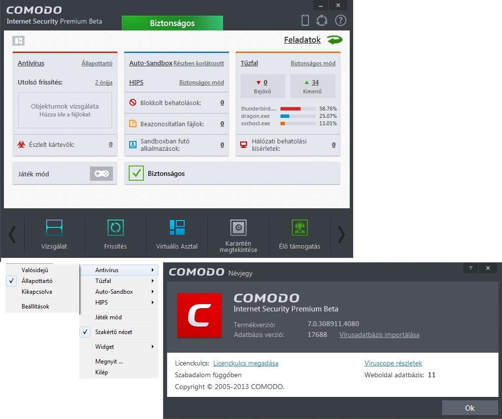

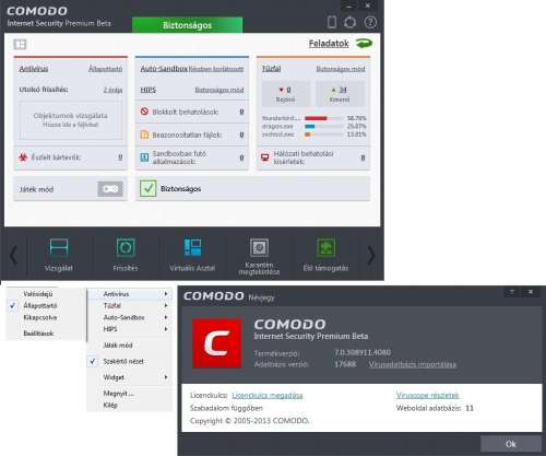

Hölgyeim és Uraim.
Letölthető a CIS 7 béta.Comodo Internet Security
http://download.comodo.com/cis/download/installs/3000_beta/standalone/cispremium_installer.exeComodo Antivirus
http://download.comodo.com/cis/download/installs/3000_beta/standalone/cav_installer.exeComodo Firewall
http://download.comodo.com/cis/download/installs/3000_beta/standalone/cfw_installer.exeWhat's new in 7.0.308911.4080?
New
Viruscope
Viruscope monitors the activities of processes running on your computer and alerts you if they attempt to take suspicious actions. Apart from forming yet another layer of malware detection and prevention, the sub-system represents a valuable addition to the core process-monitoring functionality of the Behavior Blocker by introducing the ability to reverse potentially undesirable actions of software without necessarily blocking the software entirely. This provides more granular control over otherwise legitimate software which requires certain actions to be taken in order to run correctly. Viruscope works using a constantly expanded list of activity ‘recognizers’, which allow the software to detect, block and undo many potentially unwanted actions.Website Filtering
The new website filtering section gives CIS users a powerful and easy way to allow or block access to specific websites. Website access rules can be created for particular users of your computer, which makes this feature very useful for both home and work environments. For example, parents can block juvenile users from visiting inappropriate websites while companies can prevent employees from visiting leisure sites during working hours. You also have the option to create a log event whenever a user tries to visit a website which is in conflict with a rule. CIS ships with several preset lists (or ‘categories’) of URLs which can be added to rules that you create - including the 'Malicious sites category', the 'Comodo Safe category', the 'Comodo Phishing category' and the 'Comodo Malware category'.UI Update
•The CIS user interface features several design and UX enhancements which allow you to accomplish tasks faster while keeping you better informed than ever before. New themes include the bold new ‘Metro’ theme.
•Process Activity Dialog is added.
•Added 'Please call a live expert' balloon message in main GUI when running into 'At Risk' status.
•Virtual Kiosk is renamed to Virtual DesktopImproved
•Added full support for ICMP IPv6.
•All CIS Advanced Settings components are now accessible via CisTray menu.
•Windows in 'grid view': Improved file search operation and added 'search completed' notification; added 'Jump to Folder' option; columns now retain their widths as last changed by the user.
•Fixed cursor behavior when dragging folders to 'Sandbox Objects'.
•Newly created rule in HIPS rules lists are added on the top of the list (instead of the bottom).
•AV Scan results and Rating scan results windows can be viewed in full screen mode.
•CIS UI tooltips now correspond to Windows style.
•CIS date and time format are applied from the user's Windows settings -

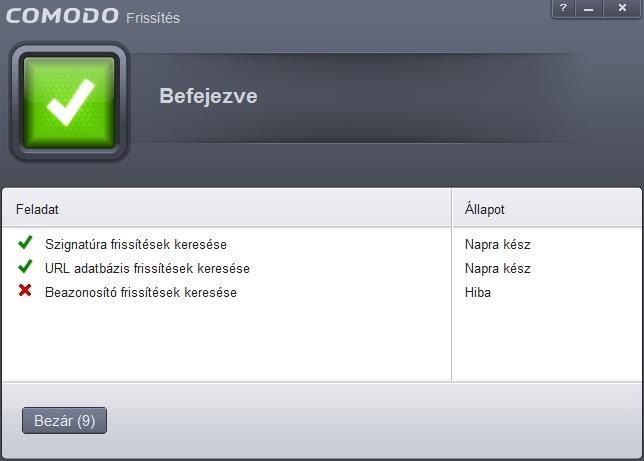

Nekem 1 napja nem frissíts a CIS...Vaylakinek van ilyen problémája?
Cs1csó
