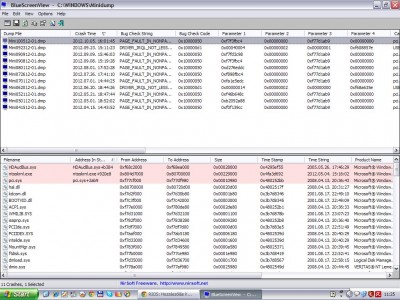

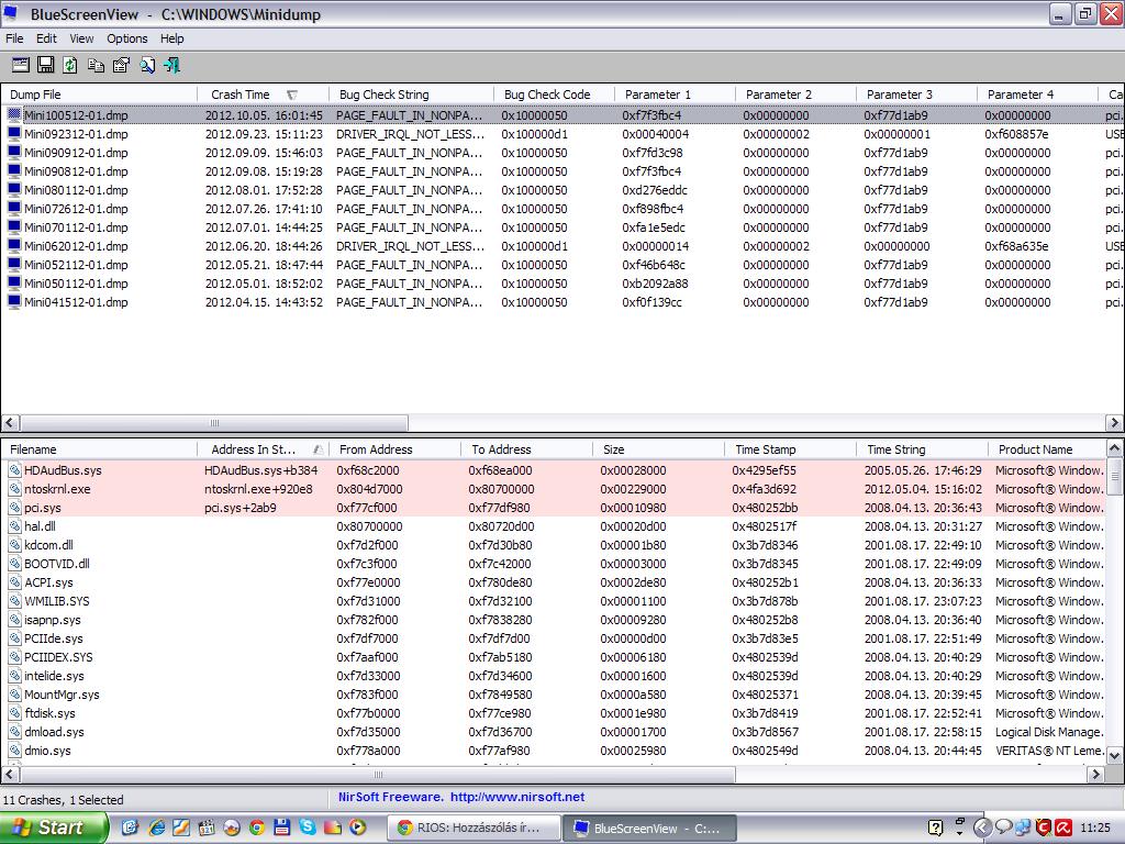

Nekem nem az indulással van problémám hanem a leállással az otthoni gépen, rendszeresen kék képernyőt dob fel. A Whocrashed logja ezt dobja ki:
System Information (local)
computer name: MAG-299A06C2FD1
windows version: Windows XP Szervizcsomag 3, 5.1, build: 2600
windows dir: C:\WINDOWS
CPU: GenuineIntel Intel(R) Pentium(R) 4 CPU 3.00GHz Intel586, level: 15
2 logical processors, active mask: 3
RAM: 1072934912 total
VM: 2147352576, free: 2026668032
Crash Dump Analysis
Crash dump directory: C:\WINDOWS\Minidump
Crash dumps are enabled on your computer.
On Fri 2012.10.05. 13:27:54 GMT your computer crashed
crash dump file: C:\WINDOWS\Minidump\Mini100512-01.dmp
This was probably caused by the following module: hdaudbus.sys (HDAudBus+0xB384)
Bugcheck code: 0x10000050 (0xFFFFFFFFF7F3FBC4, 0x0, 0xFFFFFFFFF77D1AB9, 0x0)
Error: CUSTOM_ERROR
file path: C:\WINDOWS\system32\drivers\hdaudbus.sys
product: Microsoft® Windows® Operating System
company: Windows (R) Server 2003 DDK provider
description: High Definition Audio Bus Driver v1.0a
A third party driver was identified as the probable root cause of this system error. It is suggested you look for an update for the following driver: hdaudbus.sys (High Definition Audio Bus Driver v1.0a, Windows (R) Server 2003 DDK provider).
Google query: hdaudbus.sys Windows (R) Server 2003 DDK provider CUSTOM_ERROR
On Sun 2012.09.23. 13:10:38 GMT your computer crashed
crash dump file: C:\WINDOWS\Minidump\Mini092312-01.dmp
This was probably caused by the following module: usbport.sys (USBPORT+0xD57E)
Bugcheck code: 0x100000D1 (0x40004, 0x2, 0x1, 0xFFFFFFFFF608857E)
Error: CUSTOM_ERROR
file path: C:\WINDOWS\system32\drivers\usbport.sys
company: Microsoft Corporation
description: USB 1.1 & 2.0 Port Driver
The crash took place in a standard Microsoft module. Your system configuration may be incorrect. Possibly this problem is caused by another driver on your system which cannot be identified at this time.
On Sun 2012.09.09. 10:44:20 GMT your computer crashed
crash dump file: C:\WINDOWS\Minidump\Mini090912-01.dmp
This was probably caused by the following module: hdaudbus.sys (HDAudBus+0xBDCB)
Bugcheck code: 0x10000050 (0xFFFFFFFFF7FD3C98, 0x0, 0xFFFFFFFFF77D1AB9, 0x0)
Error: CUSTOM_ERROR
On Sat 2012.09.08. 11:42:15 GMT your computer crashed
crash dump file: C:\WINDOWS\Minidump\Mini090812-01.dmp
Error: CUSTOM_ERROR
On Wed 2012.08.01. 14:27:11 GMT your computer crashed
crash dump file: C:\WINDOWS\Minidump\Mini080112-01.dmp
Bugcheck code: 0x10000050 (0xFFFFFFFFD276EDDC, 0x0, 0xFFFFFFFFF77D1AB9, 0x0)
Error: CUSTOM_ERROR
On Thu 2012.07.26. 13:30:38 GMT your computer crashed
crash dump file: C:\WINDOWS\Minidump\Mini072612-01.dmp
Bugcheck code: 0x10000050 (0xFFFFFFFFF898FBC4, 0x0, 0xFFFFFFFFF77D1AB9, 0x0)
Error: CUSTOM_ERROR
On Sun 2012.07.01. 12:43:48 GMT your computer crashed
crash dump file: C:\WINDOWS\Minidump\Mini070112-01.dmp
Bugcheck code: 0x10000050 (0xFFFFFFFFFA1E5EDC, 0x0, 0xFFFFFFFFF77D1AB9, 0x0)
Error: CUSTOM_ERROR
On Wed 2012.06.20. 16:43:42 GMT your computer crashed
crash dump file: C:\WINDOWS\Minidump\Mini062012-01.dmp
This was probably caused by the following module: usbvm323.sys (usbvm323+0x2E6A8)
Bugcheck code: 0x100000D1 (0x14, 0x2, 0x0, 0xFFFFFFFFF68A635E)
Error: CUSTOM_ERROR
file path: C:\WINDOWS\system32\drivers\usbvm323.sys
product: VM321
company: Vimicro Corporation
description: VM323 Video Driver
A third party driver was identified as the probable root cause of this system error. It is suggested you look for an update for the following driver: usbvm323.sys (VM323 Video Driver, Vimicro Corporation).
Google query: usbvm323.sys Vimicro Corporation CUSTOM_ERROR
On Mon 2012.05.21. 16:47:07 GMT your computer crashed
crash dump file: C:\WINDOWS\Minidump\Mini052112-01.dmp
Bugcheck code: 0x10000050 (0xFFFFFFFFF46B648C, 0x0, 0xFFFFFFFFF77D1AB9, 0x0)
Error: CUSTOM_ERROR
On Tue 2012.05.01. 15:03:02 GMT your computer crashed
crash dump file: C:\WINDOWS\Minidump\Mini050112-01.dmp
Bugcheck code: 0x10000050 (0xFFFFFFFFB2092A88, 0x0, 0xFFFFFFFFF77D1AB9, 0x0)
Error: CUSTOM_ERROR
On Sun 2012.04.15. 11:09:43 GMT your computer crashed
crash dump file: C:\WINDOWS\Minidump\Mini041512-01.dmp
Bugcheck code: 0x10000050 (0xFFFFFFFFF0F139CC, 0x0, 0xFFFFFFFFF77D1AB9, 0x0)
Error: CUSTOM_ERROR
Conclusion
11 crash dumps have been found and analyzed. 2 third party drivers have been identified to be causing system crashes on your computer. It is strongly suggested that you check for updates for these drivers on their company websites. Click on the links below to search with Google for updates for these drivers:
If no updates for these drivers are available, try searching with Google on the names of these drivers in combination the errors that have been reported for these drivers and include the brand and model name of your computer as well in the query. This often yields interesting results from discussions from users who have been experiencing similar problems.
Read the topic general suggestions for troubleshooting system crashes for more information.
Note that it's not always possible to state with certainty whether a reported driver is actually responsible for crashing your system or that the root cause is in another module. Nonetheless it's suggested you look for updates for the products that these drivers belong to and regularly visit Windows update or enable automatic updates for Windows. In case a piece of malfunctioning hardware is causing trouble, a search with Google on the bug check errors together with the model name and brand of your computer may help you investigate this further.Itt pedig egy kép a BluescreenViewból:
Mit lehet ezzel kezdeni?
