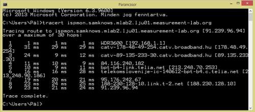

vargalex
Akkor talán ki is derült: szlovén szerverre kellene a speedtest-et is megnézni a PC-n...
Még valami: az én méréseim NAT-olással történtek, így akár még jóval nagyobb mérés is elképzelhető. Alkalomadtán megnézem.
poli27
Megírtam nekik hogy ez nem jó, ez volt a válaszuk! Másnál mit jelez a tracert?
Hello,
The readings vary quite a bit. We suspect there is a peering issue somewhere...
The WDR3600 is perfectly capable of handling speeds up to about 500mbits, so that's not the problem.
I wonder if you can do a traceroute to ispmon.samknows.mlab2.lju01.measurement-lab.org?
Open up cmd on your computer, enter this:
tracert ispmon.samknows.mlab2.lju01.measurement-lab.org
It can take a minute to complete the full trace, can you please take screenshot of the results and attach it to me in your response?
Also, do you know if your ISP restricts international traffic? We are using a server in Slovenia to do the tests, but if your ISP restricts international traffic, that might also explain why it's slow...
Kind regards,
Ati
The SamKnows Team

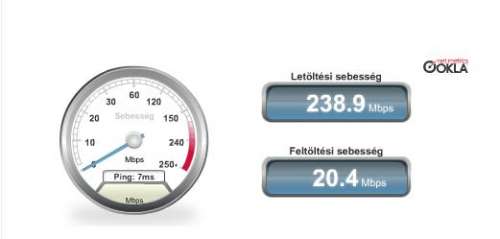

Mai mérés:
03:00 20.25 Mbps
09:00 34.07 MbpsEz még a 60-as netet se tudná itt kimérni....

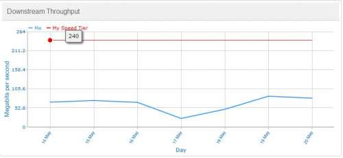

Levélváltásom:
Hi, I've got 240 / 20 Mbit/s internet at UPC Hungary with Samknows whitebox 3.0. I noticed it cant measure the right speed. I measured it myself a few times, and I had the promised speed most of the time. The whitebox could only measure the third of it. I set it up correctly, thats sure, and no downloading is going in between.
Should this work so?
If yes, whats the point of the survey?Thanks for your help in advance!
Válasz:
Hello Máté,
Thank you for contacting SamKnows about your SamKnows Whitebox.
The SamKnows Whitebox can measure fixed-line broadband
connections of up to 540 mbps.Can you confirm your set up is:
Modem > Router > Whitebox > Wired devices
Having checked the speeds we are getting from you are very variable.
Please confirm all wired devices are attached to the Whitebox, none are conencted to the Router. All traffic must move through the device.
I look forward to your response.
Kind regards,
Karen

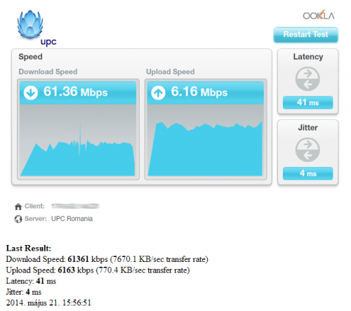

vargalex
A szolgáltatás minőségét persze, hogy nem csak az elérhető sávszélesség határozza meg. És nem is csak azt méri az eszköz...
A sebbességnél pont erről beszéltem, amit írsz: ellenőrizted, hogy magyar szervereken hozza a sebességet. De a box nem ott mér... És gondolom letölteni is leginkább magyar szerverekről (vagy torrenten magyar peer-ektől) szoktál.

poli27
Ennek így nincs értelme sztem!
Downstream Throughput
Date Average (Mbps)
19:00 64.57
18:00 58.04
17:00 34.69
13:00 81.29
07:00 80.98
01:00 94.09 -
