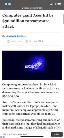

gaborbol
bobsys #24824 üzenetére
cnn:
Attacks stemming from the Exchange software flaws are on the rise. On Thursday, Microsoft and security researchers warned that the vulnerabilities are now being combined with another potent cybersecurity threat: ransomware, which locks up a computer or a network's files and holds them hostage until the victim pays a fee.
https://www.bleepingcomputer.com/news/security/ransomware-now-attacks-microsoft-exchange-servers-with-proxylogon-exploits/
