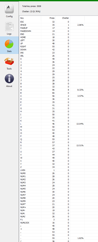

Chattering kiszűrésére van szoftveres út:
https://www.softpedia.com/get/System/System-Miscellaneous/Keyboard-Chattering-Fix.shtml -
