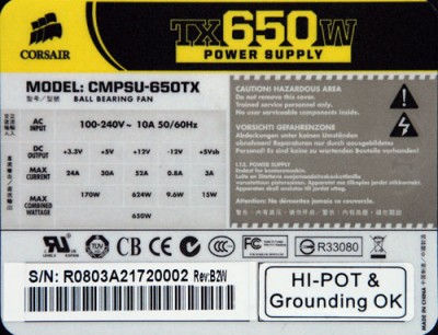

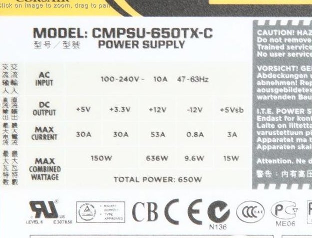

Corsair TX 650 CMPSU-650TX-C CWT
Corsair TX 650 CMPSU-650TX Seasonic -
