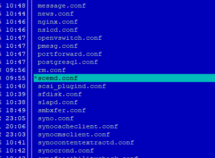

zsolt20
válasz DJ. Ru$y #24534 üzenetére
Igy van ..
Ezt módosítottam és mentés után csillagozott lett a file . Mit jelent a *?
I created two files:
1) /usr/local/etc/syslog-ng/patterndb.d/scemd.conf
2) /usr/local/etc/syslog-ng/patterndb.d/include/not2msg/scemd
These configuration files affect the syslog messages that Synology delivers to /var/log/messages. The log you are trying to affect is /var/log/scemd.log and unfortunately there is no extensible user configuration for this. The file that controls /var/log/scemd.log is /etc.defaults/syslog-ng/patterndb.d/scemd.conf which must be edited directly in order to make the change you want.
You will be inclined to make a backup of this file in the same directory, but don't. Store a backup elsewhere. Regardless of how it's named, if it's in the directory, the parser will grab it and try to execute it - which will either not do what you intend, or crash syslog-ng.
The other consequence of modifying a file in this location is that it may be overwritten by a DSM upgrade. If that happens, you'll need to verify that the new file's function is the same, and then reapply the edits below, making any required adjustments:
Original /etc.defaults/syslog-ng/patterndb.d/scemd.conf from DS3617xs DSM 6.2.3
filter f_scemd { program(scemd); }; filter f_scemd_sev { level(err..emerg) }; destination d_scemd { file("/var/log/scemd.log"); }; log { source(src); filter(f_scemd); filter(f_scemd_sev); destination(d_scemd); };Example modified /etc.defaults/syslog-ng/patterndb.d/scemd.conf to suppress the desired error messages
# begin scemd.conf patch to suppress ioctl messages filter fs_scemd { program(scemd); }; filter fs_scemd_ioctl { match("polling_.*ioctl\ device\ failed$" value("MESSAGE")); }; filter f_scemd { filter(fs_scemd) and not filter(fs_scemd_ioctl); }; # end scemd.conf patch filter f_scemd_sev { level(err..emerg) }; destination d_scemd { file("/var/log/scemd.log"); }; log { source(src); filter(f_scemd); filter(f_scemd_sev); destination(d_scemd); };synoservice --restart syslog-ng does not always implement changes to the files in /etc.defaults/syslog-ng (this may be because they are copied to /etc before execution, but I've found that sometimes it works and sometimes it doesn't). To be certain, restart the NAS to be certain that syslog-ng is completely reloaded and the file structure is reinitialized. You should see some initialization events in the log post-boot, if everything is working okay.
Edited August 20, 2020 by flyride -

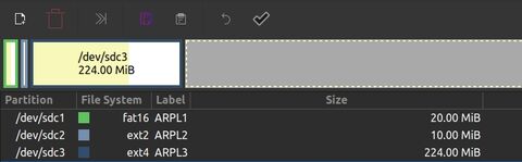

hoktar
válasz DJ. Ru$y #23825 üzenetére
Már jóval a bejegyzés írása előtt próbáltam (25MB + 25MB 192MB partíció átméretezésekkel Gparted Live és és legfrissebb Gparted-el futó PC Linux OS alól. Az ext2-es és Ext 3-as partíció átméretezésekor elvérzett (később csatolok képet). Megpróbálnád te is, ha szépen megkérlek?! Hátha én vagyok nagyon láma.
[ Szerkesztve ]
Migiri-Migiri-Megyek!
