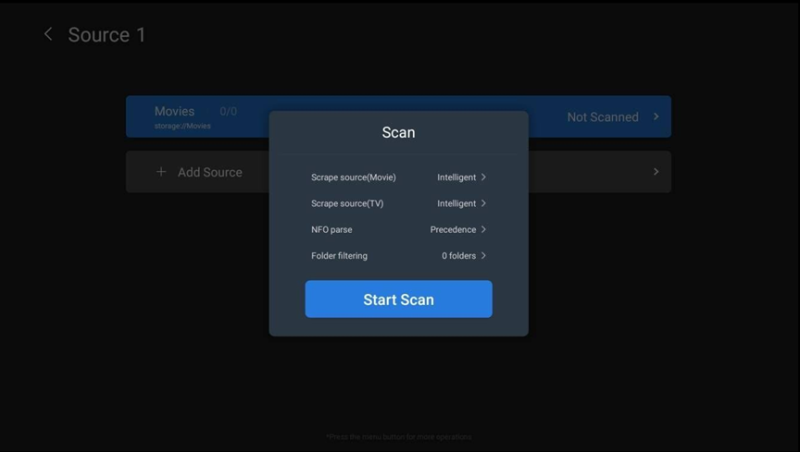

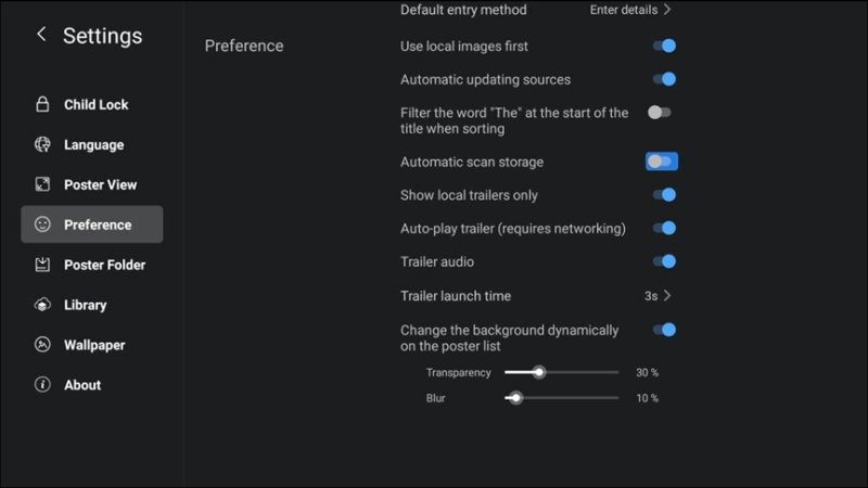

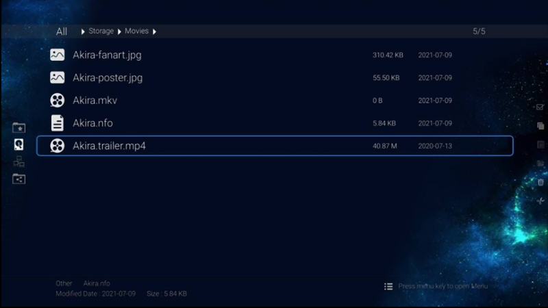

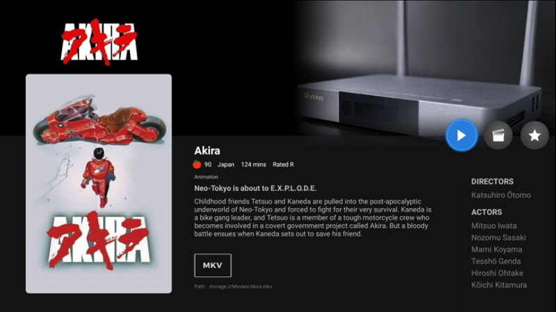

If you have some videos taken by yourself and want to display them on the Zidoo Poster Wall, this quick guide will be helpful. Let’s have a look at the custom posters, fanart and trailer firstly.
Preparation
1. Poster:1200x1800px and named it as "videoname-poster.jpg".
2. Fanart:1920x1080px and named it as "videoname-fanart.jpg".
3. Trailer: name it as "videoname.trailer.mp4".
4. The self-recorded video.
5. Clearlogo: 800x301px and named it as “videoname-clearlogo.png”
Setting
Home Theater>Settings>Preferences>Use local images first/Show local trailers only.
Quick Guide
Insert the USB drive that stored files we prepared into the Zidoo media player, then find path: Home Theater>Source>Find relevant files>Start scanning>Finish scanning and see the custom posters. -
