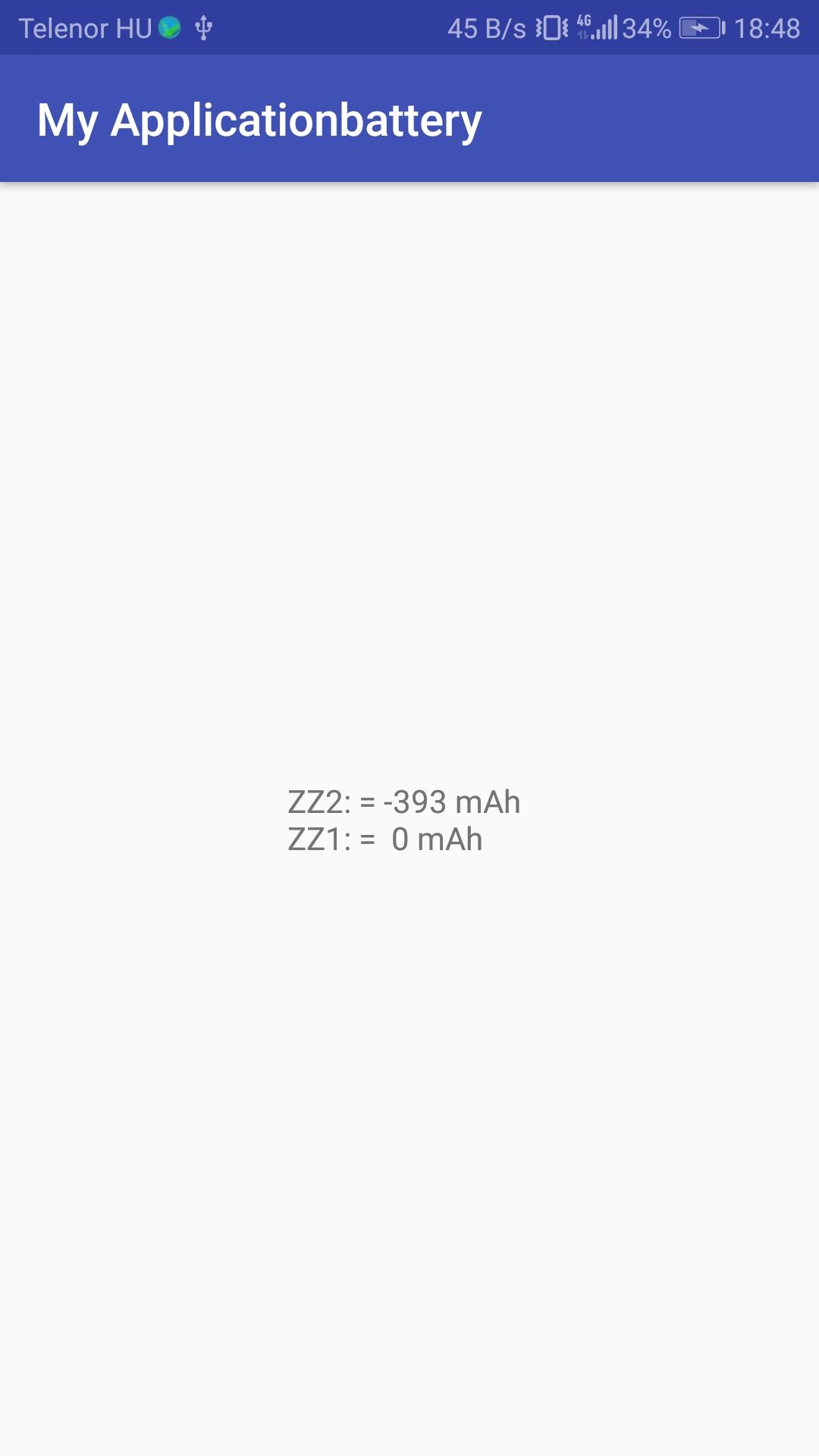

Ezt valaki ki tudná próbálni? A kód elvileg kiírja, hogy hány miliamperrel tölt a telefon... akinél működik, az írja meg lécci, hogy mi a telefon márkája. Köcce!
public class MainActivity extends AppCompatActivity {
private TextView textView;
@Override
protected void onCreate(Bundle savedInstanceState) {
super.onCreate(savedInstanceState);
setContentView(R.layout.activity_main);
textView = (TextView) findViewById(R.id.textView);
this.registerReceiver(this.batteryinfoReceiver, new IntentFilter(Intent.ACTION_BATTERY_CHANGED));
private BroadcastReceiver batteryinfoReceiver = new BroadcastReceiver(){
public void onReceive(Context context, Intent intent){
long currentInstantMicroAmperes = 0;
long currentAvgMicroAmperes = 0;
BatteryManager batteryManager = (BatteryManager) context.getSystemService(context.BATTERY_SERVICE);
currentInstantMicroAmperes = getSpecialValue(batteryManager, BatteryManager.BATTERY_PROPERTY_CURRENT_NOW);
currentAvgMicroAmperes = getSpecialValue(batteryManager, BatteryManager.BATTERY_PROPERTY_CURRENT_AVERAGE);
textView.setText("ZZ2: = "+ currentInstantMicroAmperes + " mAh"+"\n"+
"ZZ1: = " + currentAvgMicroAmperes + " mAh");
private int getSpecialValue(BatteryManager batteryManager, int key) {
int value = batteryManager.getIntProperty(key);
return value;
