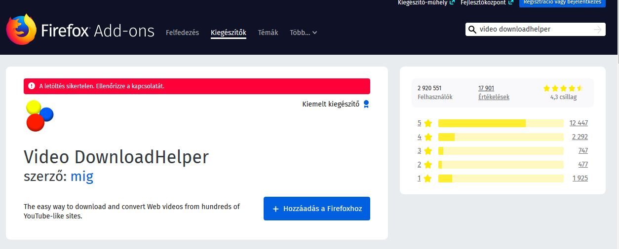

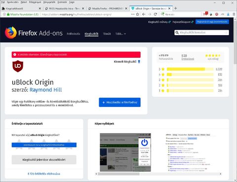

Na kb 15 perce Androidon is beütött nállam a plugin bug.
Pl az ublock egyszercsak eltünt, majd mikor újra akartam rakni, ez fogadott.Adguard-nál szintén.

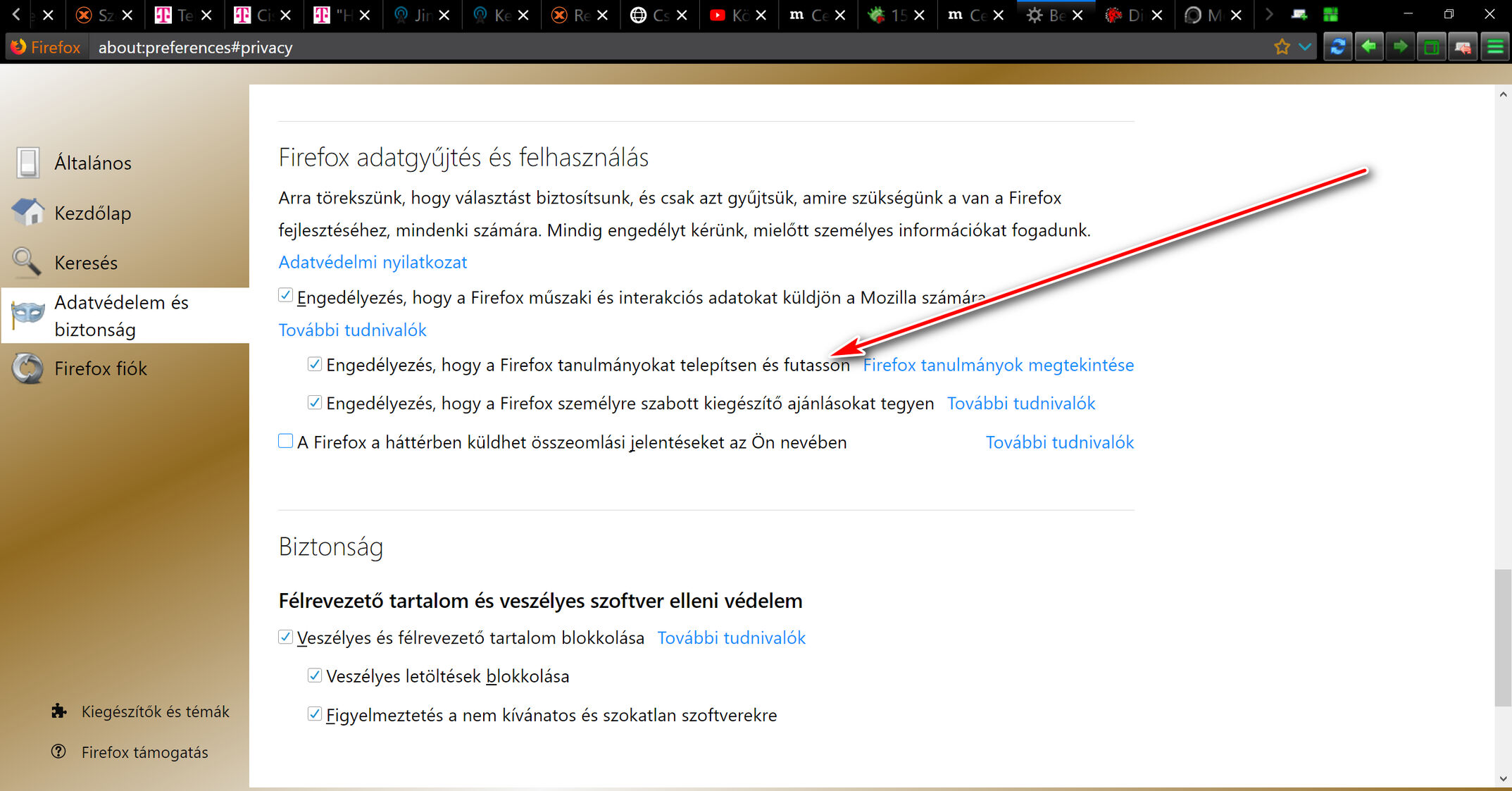

Az első jó hír: Certificate issue causing add-ons to be disabled or fail to install
"12:50 p.m. UTC / 03:50 a.m. PDT: We rolled-out a fix for release, beta and nightly users. The fix will be automatically applied in the background within the next few hours, you don’t need to take active steps.
In order to be able to provide this fix on short notice, we are using the Studies system. You can check if you have studies enabled by going to Firefox Preferences -> Privacy & Security -> Allow Firefox to install and run studies.
You can disable studies again after your add-ons have been re-enabled.
We are working on a general fix that doesn’t need to rely on this and will keep you updated."
