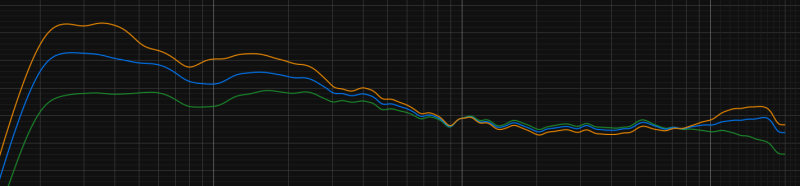

skippper #189031 üzenetére
Időközben amúgy visszaírt a Dirac support is:
Hello,
I think that you refer to the Equal-loudness contour and in general, your reasoning makes complete sense.
In this case, you may want to compensate for the differences between the curves,
the differences change according to the SPL you take as a reference though… -
