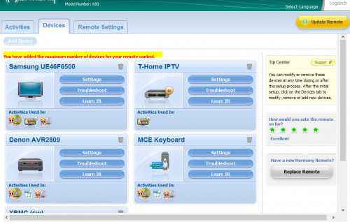

Jah, megerősítették:
Previously Harmony 650 remotes were using Harmony Remote Software and there it was possible to add 5 devices only.
Currently Harmony 650 remotes are using myharmony.com interface and it allows to add 8 devices.
In our current selection the P/N is being marked as 915-000229.
915-000161 should behave the same way, at it is related to firmware and interface, not the remote hardware. So both numbers can handle 8 devices, 5 devices is old information. -
Zebu
Itt a válasz, 8 eszköz:
Thank you for contacting Logitech.
My name is Harri K., I understand that you would like assistance with your Harmony 650.
Please note that Harmony 650 remote can handle 8 devices.
I was checking our database and couldn't find THOME as a manufacturer.
However under T-Online there are several T-HOME models
Manufacturer Model
T-Online T-HOMEX300TPlease note that Harmony 650 can also learn commands from original remote.
