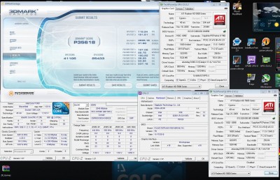

MontyCrew
Alaplap: EVGA P55 MICRO
CPU: i7 860
RAM: 4*2GB 1333DDR3
VGA: 2*GigaByte 6850 OCproci/vga alapon
proci alapon/vga 875/1150
proci@4200/vga alapon
proci@4200/vga 875/1150 -
