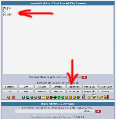

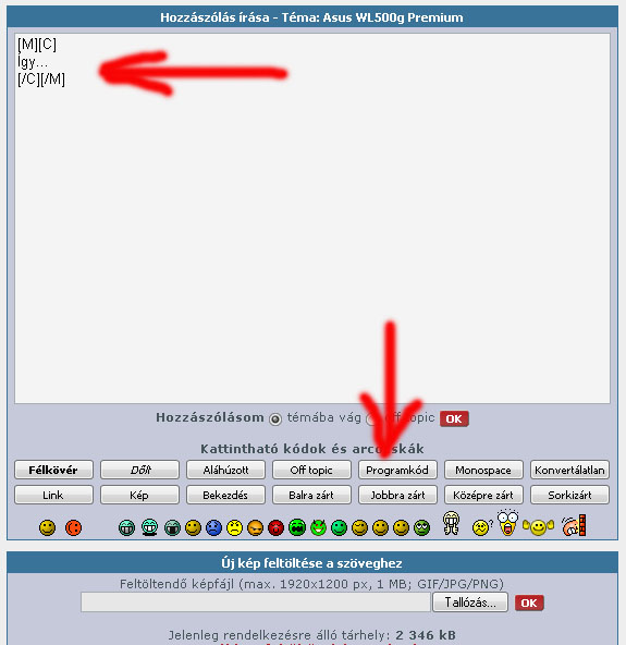

GML
Intruder2k5 #11955 üzenetére
hogyan kell így beszúrni a dolgokat, hogy scrollbar legyen alul és ne legyen sortörés?
Próbáld így esetleg:
insmod ipt_recent
iptables -D INPUT -j DROP
iptables -I INPUT -p tcp --dport 21 -j ACCEPT
iptables -t nat -A PREROUTING -i vlan1 -p tcp --dport 21 -j DNAT --to-destination 192.168.1.1:21

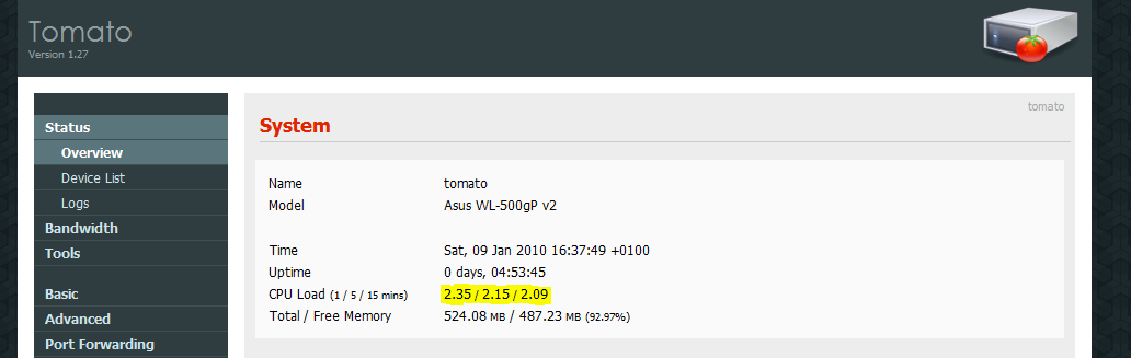

ez reboot után fogadott:
Load average: 1.70 1.75 1.72 2/53 11839
PID PPID USER STAT VSZ %MEM %CPU COMMAND
1 0 root R 1036 3% 88% /sbin/init noinitrd
11783 89 root S 996 3% 6% dropbear -p 22 -a
11839 11786 root R 1480 5% 5% top
9534 9526 root S 16328 53% 0% /opt/bin/php-fcgi
9535 9526 root S 16316 53% 0% /opt/bin/php-fcgi
9526 9525 root S 16260 53% 0% /opt/bin/php-fcgi
376 328 root S N 11120 36% 0% /opt/bin/rtorrent -n -o import=/opt/etc/rtorrent.conf
283 189 root S 7396 24% 0% /opt/libexec/mysqld --basedir=/opt --datadir=/mmc/data/mysql --user=root --pid-file=/mmc/data/mysql/.pid --skip-ext
319 283 root S 7396 24% 0% /opt/libexec/mysqld --basedir=/opt --datadir=/mmc/data/mysql --user=root --pid-file=/mmc/data/mysql/.pid --skip-ext
320 319 root S 7396 24% 0% /opt/libexec/mysqld --basedir=/opt --datadir=/mmc/data/mysql --user=root --pid-file=/mmc/data/mysql/.pid --skip-ext
11343 11339 root S 5332 17% 0% mc -c
11433 11428 root S 5084 17% 0% mc -c
6838 678 root S 4988 16% 0% mc -c
9525 1 root S 4324 14% 0% /opt/sbin/lighttpd -f /opt/etc/lighttpd/lighttpd.conf
328 1 root S 1972 6% 0% /opt/bin/SCREEN -dm -S rtorrent
1650 1 root S 1964 6% 0% /opt/bin/SCREEN -dm -h 0 -S ewget
145 1 root S 1856 6% 0% smbd -D
142 1 root S 1616 5% 0% nmbd -D
144 142 root S 1580 5% 0% nmbd -D
111 1 root S 1492 5% 0% crond
189 1 root S 1488 5% 0% /bin/sh /opt/bin/mysqld_safe --datadir=/mmc/data/mysql --pid-file=/mmc/data/mysql/.pid
11428 11424 root S 1484 5% 0% -sh
678 675 root S 1484 5% 0% -sh
11339 11338 root S 1484 5% 0% -sh
1664 1650 root S 1484 5% 0% /bin/sh
11786 11783 root S 1484 5% 0% -sh
338 328 root S 1484 5% 0% /bin/sh
523 1 root S 1484 5% 0% udhcpc -i vlan1 -s dhcpc-event -H tomato -S
88 1 root S 1472 5% 0% syslogd -L -s 50
84 1 root S 1472 5% 0% telnetd -p 23
91 1 root S 1468 5% 0% klogd
123 1 root S 1100 4% 0% httpd -s
104 1 root S 1028 3% 0% nas /etc/nas.conf /var/run/nas.pid lan
675 89 root S 1008 3% 0% dropbear -p 22 -a
11338 89 root S 996 3% 0% dropbear -p 22 -a
11424 89 root S 996 3% 0% dropbear -p 22 -a
89 1 root S 940 3% 0% dropbear -p 22 -a
147 1 root S 860 3% 0% vsftpd
115 1 root S 780 3% 0% rstats
107 1 nobody S 680 2% 0% dnsmasq
43 1 root S 504 2% 0% p9100d -b -f /dev/usb/lp0 0
101 1 root SW 0 0% 0% [usb-storage-0] -
