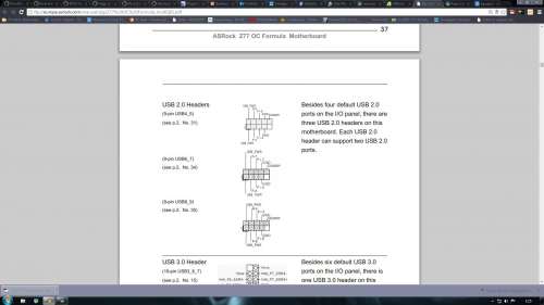

Drizzt01
Most nézem , nem mindegyik usb aljzat egyforma alapomon . Van 5v-os , 7-es és 9-es .
Drizzt01
DigitXT #12221 üzenetére
USB nélkül megy rendesen , v4.22 van rajta .
A manual csak ennyit ír .onnection possibility for an internal USB-connector on the mainboard.
Use the included USB-cable and pay close attention to the polarity (colored wires) of the cable. Incorrect use may result Incorrect use may result in the destruction of in the destruction of
the aquaero and/or the mainboard and further components! Therefore
pay close attention to the pin assignment of the connectors on the
mainboard. Please consult the manual of your mainboard for help.Azt a szürkét amit kaptam hozzá .
