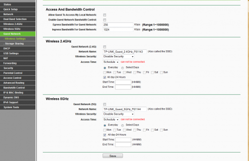

Itt vannak a wifi beállításaim -

semmi se történik ha kiadom a wifi parancsot ssh-n.És csak 17db ig lehet állítani az 5ghz et.
config wifi-device 'radio0'
option type 'mac80211'
option channel '11'
option hwmode '11ng'
option path 'platform/ar934x_wmac'
list ht_capab 'LDPC'
list ht_capab 'SHORT-GI-20'
list ht_capab 'SHORT-GI-40'
list ht_capab 'TX-STBC'
list ht_capab 'RX-STBC1'
list ht_capab 'DSSS_CCK-40'
option txpower '22'
option htmode 'HT40-'
option country 'HU'config wifi-iface
option device 'radio0'
option network 'lan'
option mode 'ap'
option ssid 'Pocok_2,4Ghz'
option encryption 'psk-mixed'
option key 'Kakukk01'config wifi-device 'radio1'
option hwmode '11na'
option path 'pci0000:00/0000:00:00.0'
option txpower '17'
option htmode 'HT40+'
option country 'HU'
option channel '40'config wifi-iface
option device 'radio1'
option mode 'ap'
option ssid 'Pocok_5Ghz'
option network 'lan' -
