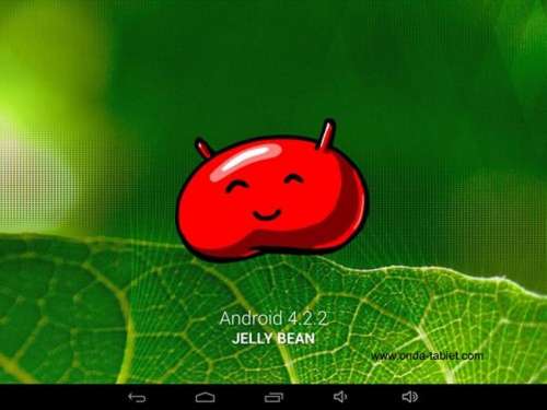

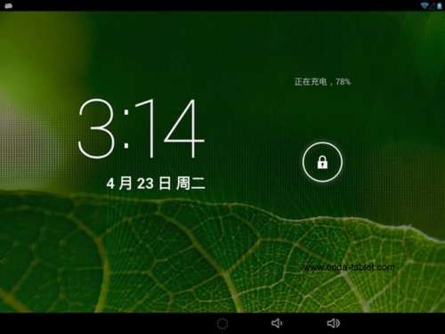

zolkas68
4.2.2
Onda V972 Quad Core Tablet Android 4.2.2 Betaletöltő oldal: http://pan.baidu.com/share/link?shareid=401559&uk=389436537
V1 verzió:
http://60.210.21.248/cdn.baidupcs.com/file/5eaaf6b2be3caee911e8d256926960a2?fid=389436537-250528-3892821268&time=1366858926&sign=FDTAR-DCb740ccc5511e5e8fedcff06b081203-jjZmY94gXNs693TwWzzle2s0N84%3D&rt=sh&expires=8h&r=589714075&sh=1&xcode=173629bddd9b0a9675206d8bcd69a531&redirect=1V2 verzió:
http://222.133.46.198/cdn.baidupcs.com/file/7928293ef309fb7d4ba477f3bc13dbd5?fid=389436537-250528-744794461&time=1366858926&sign=FDTAR-DCb740ccc5511e5e8fedcff06b081203-GABxH3Sdw51nkDIF0aN6Pb2SgP4%3D&rt=sh&expires=8h&r=312619396&sh=1&xcode=2722c1d2ca893becf1a2f9cba01e8d41&redirect=1Szép napot.
