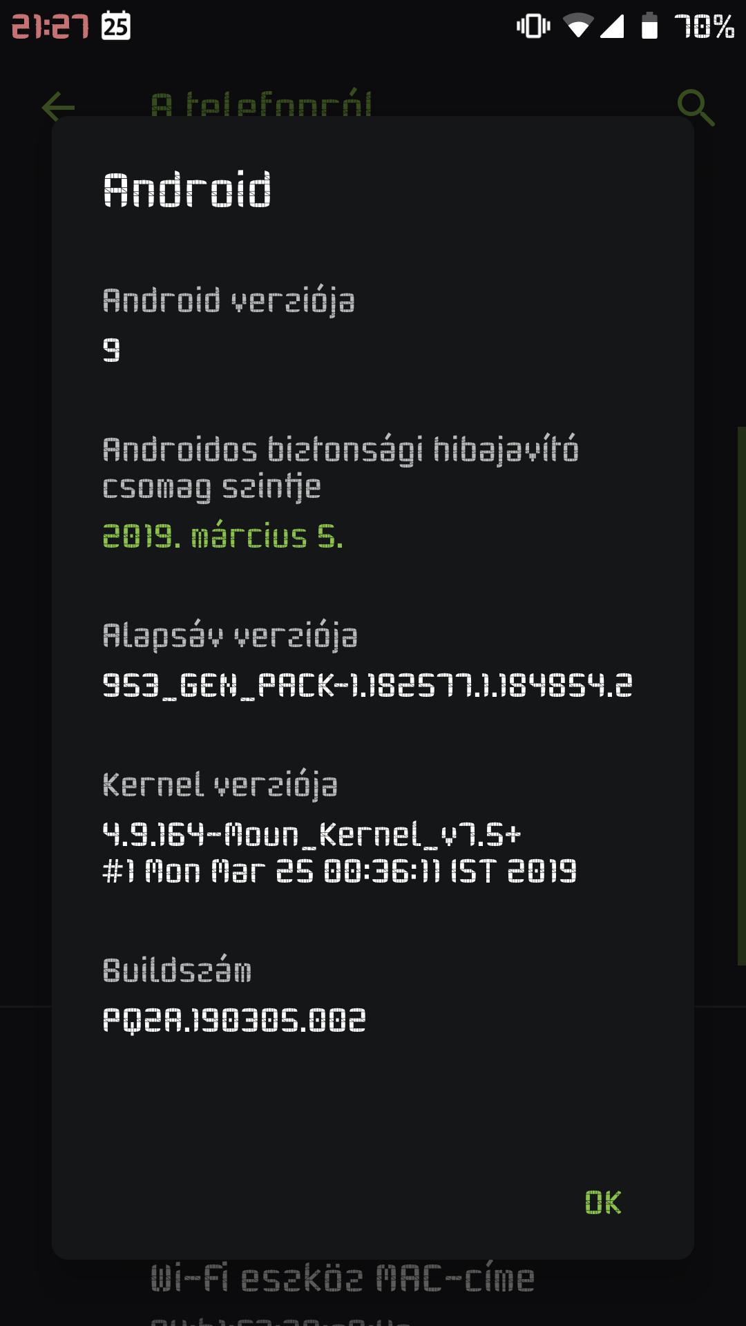

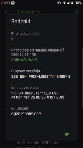

Maffia91
Márciusi frissítés megjött már valakinek? -
Nagyon belehúztak a fiúk:
Havoc-OS-v2.3-20190324-tissot-Official.zip
Updated Vendor Libs from the latest Stock Firmware
Fully Dexpreopted the Build for faster Seamles OTA flashing
Added Bult-in Spectrum support with Moun Kernel Intergation
Moun Kernel V7.5
Kernel Upstream to 4.9.164
Caf and Drivers Upstreams
Wfi Driver Prima Upstream
Added QS panel inspired by OOS
Added Music ticker inspired by Android Q
Added back the dividers in settings
Added back Screen-off animation
Added toggle to hide wifi icon
Added new icon for Sim toolkit
Added MD2 icons for power menu
Improved expanded volume panel layout
Improved and cleaned up Settings
Fixed OnePlus gestures in landscape
Fixed a few settings seekbars
Fixed some theme glitches
Fixed double vibration on pill navbar -
