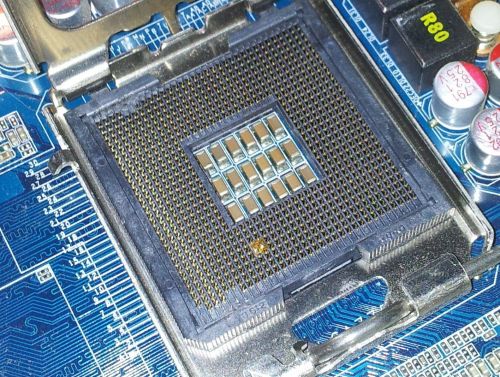

Vannak itt is erdekessegek:http://www.overclock.net/t/1545188/asus-p5q3-x5460-no-post
Originally Posted by gagarin77 View Post
Hi I had like 100 Xeons running on my P5Q3 Deluxe. Both of the motherboards you mentioned should be OK for this mod.
You need to do some checking on your modded equipment.
1. Make sure you have default settings in the BIOS before installing Xeon (All settings Auto, no OC, Advanced C state C2/C3 - Disabled).

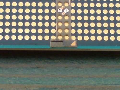

2. Check the plastic tabs in the socket - they should be cut straight to the bottom and be exactly even with the frame. (this is the usual cause most of the time when people say they rig refuses to POST)
3. Check if adapter is in the right place (correct row/column)
4. Make sure you are installing Xeon oriented correctly - with the golden triangle corresponding to the one on the socket's latch and PCB. I recommend to move the cpu few times from side to side before locking it.
5. Check if the cpu heat sink has all its mounts locked correctly.In your case there is also a possibility that you have problems related to RAM so you should try with only one module (preferably installed in the last slot).
Oh I nearly forgot I had one additional plastic tab on P5Q3 DLX - lying horizontally at the bottom of the socket, near the frame. I cold run the mod with this bar still there but it was causing to flatter the adhesive side of the adapter, so I cut it out.
http://www.overclock.net/t/1431723/mod-lga775-support-for-lga771-xeon-cpus/3330#post_22215699
http://www.overclock.net/t/1431723/mod-lga775-support-for-lga771-xeon-cpus/3340#post_22218188 -

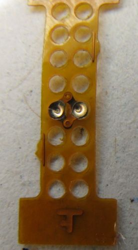

Elvileg jó matrica és gyakorlatilag jó matrica között ez a difi..nekem is volt, hogy minden jónak tűnt, mégsem volt okés, csere megoldotta. Foglalat módosítása meg abszolute veszélytelenül kivitelezhető egy rendes 775 procit bennehagyva, mellette dolgozva a pengével. Inkább, minthogy egy procit reszelgessek, ami enyhén szólva érzékenyebb.. -

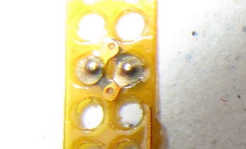

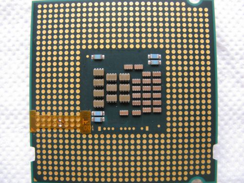

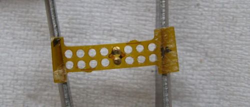

Tehát folytatom a projectet.
Ma kimértem a matricát és tökéletesen teszi a dolgát,felcseréli az érintkezőket,ez nem a már feljebb emlitett probléma oka.Csináltam pár képet is amin látszik,hogy nincsen átszakadva sehol.Ezekután vagy a bios (lehet nincsen benne az x5260 microcode)vagy a proci a kieső.Itt látható,hogy rosszul gyártották le a lyukakat a matricán,jobb kettő furatot már javítottam:

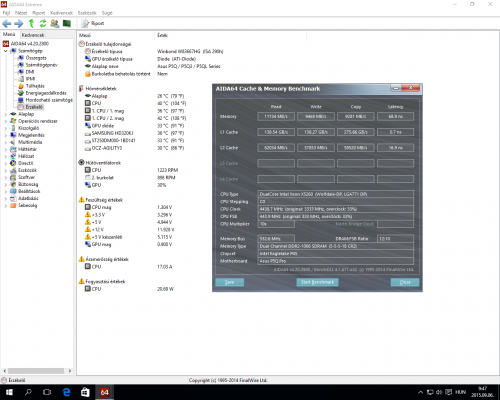

Hát 415 ös FSB vel még ment stabilan 1,30 volton, 423 on még elindult, de már leállt a stress test kb 2 perc után 1,31 volt felett kicsivel, és mindenféle furcsaságokat csinált a gép....Ezt még talán magasabb fesszel stabillá lehetett volna tenni, de 200MHz ért nem találtam érdemesnek erőltetni a dolgot..... 433 on asztal betöltésénél kifagyott, automatikus feszültséggel is... :S A ramot nem tudom 1:1 nél lejjebb venni sajnos, tehát minden 400 as feletti FSB-nél , már túl van hajtva a ram. Az 1066 os ramokkal talán menne feljebb, de 8 gigáról visszamenni 4 re megint nem akartam, így is rendszer újratelepítés lett a vége a próbálkozásnak...
Speed®
A memvezérlőnek okoz nehézséget, főleg OC mellett. Persze feszültségemeléssel többnyire stabilizálható. Simán mehet a procid 450es FSBvel 4Gn, ha a RAMokat be tudod lőni mellé és értelmes darab, nyilván akkor derül ki, ha elkezded tesztelni, milyen az élet 400as FSB felett..maga a P45 chipset partner ebben (sőt, a P35ök is simán mentek 450et többnyire). Proci fogyasztása nyilván emelkedik, de az alkalmazott fesz függvénye ez, ill. mind megkéri a magáét..Yorkfield topikban találsz tapasztalatokat bőven. Persze ha kis fogyasztással szeretnéd mindezt, hajthatsz egy L830B550 Q9550et annyiért, amennyiért i5öt kapsz

Ha p5ql pro a alap és a BIOS is akkor mehet, csak az ASUS hasonló néven legalább 5 fajta lapot készít, de csak a teljesen hozzávalót szabad felhasználni. (gygabyte-nél sem mindegy pl hogy GA-EP35-DS4 vagy GA-P35-DS4)
Ha nem sürgető Aliexpressen vagy Ebayen érdemes matricát venni 10x csomagban olcsón. (mert néhány rossz, nemárt ha van tartalék)

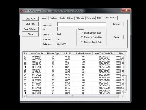

M3lakH
Valószínűleg nincs a BIOSban 1067a mikrokód (E0) C0 meg ven benne. Elviekben ha találsz az alaplaphoz leírást akkor kel lenni CPU support listának, esetleg ha rájössz melyik bios fájlban lehet a mikrokód akkor intelmicrocodelisr.exe kilistázza a benn levő mikrokódot.
DE szerintem 90%-ban menne. És jó csere másnak mert E0 jobban húzható általában... -

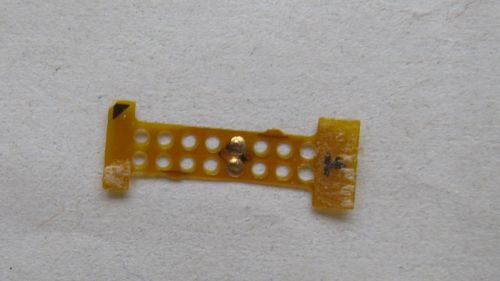

Elkezdtem a multheten egy ilyen projectet egy asus p5ql pro lapon egy x5260-al,äm meg a pörgö ventiktöl es sötet keprenyötöl (melegedö procitol)nem jutottam toväbb.Ha visszarakom a regi e7500-as procit indul rendesen.Biosokkal probälkoztam,de ällitolag attol meg elkellene indulnia a gyäri biossal is(van aki azt mondja,hogy mär a biostol is lehetnek ezek a tünetek).Kiderült meg,hogy a matricän elegge kicsik es eltolodottak voltak a lyukak,ezeket egy 0.8-as csigafuroval
sikerült feljavitanom,hasznälhato modszer!A következö amit tervezek a matricaerintkezök kimerese az esetleges hibäs pin-forrasztäs kideritesehez.
Toväbbi ötleteket szivesen olvasok!
