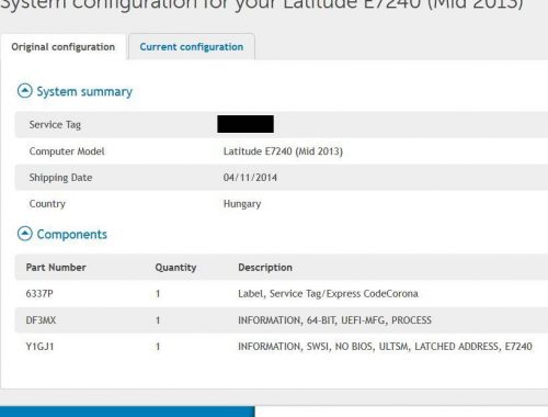

zsofika11 #46283 üzenetére
Na, megint tanultam valami újat. ROTFL
Szerintem nem kicsit kapnának röhögőgörcsöt, ha innen bármelyik sort írnám be a formba, eredeti tulajkéntCountry
Hungary
Components
Part Number
Quantity
Description
6337P
1
LATITUDE E7240
DF3MX
1
INTEL CORE I5-4200U PROCESSOR BASE WITH
6MX7M
1
4TH GEN INTEL CORE I5-4200U PROCESSOR (1
T2VVD
1
ENERGY STAR 5.0 ENABLED / EPEAT GOLD
XJ3YJ
1
12.5" HD (1366X768) LED-BACKLIT LCD NON-
864KE
1
FINGERPRINT READER AND SMART CARD READER
W21JJ
1
LIGHT SENSITIVE WEBCAM AND NOISE CANCELL
W21JJ
1
DOCUMENTATION : ENGLISH SHIPPING DOCS
W21JJ
1
SYSTEM DRIVER, LATITUDE E7240
63F4F
1
SYSTEM SHIPMENT, LATITUDE E7240
G451F
1
ENGLISH SETUP AND FEATURES GUIDE
MDK25
1
4GB SINGLE CHANNEL DDR3L 1600MHZ (4GBX1)
Y5WW1
1
64GB MOBILITY SOLID STATE DRIVE
W21JJ
1
NO RESOURCE DVD
22DD2
1
UK POWER CORD
W3R2K
1
3-CELL (31WH) BATTERY
TR2C9
1
NOT SELECTED IN THIS CONFIGURATION~(G3WN
Y18M4
1
INTEL(R) CORE(TM) I5 LABEL
WHHTX
1
REGULATORY LABEL, LATITUDE E7240
WP6YC
1
INTEL INTEGRATED HD 4400 GRAPHICS
0616F
1
65W AC ADAPTER, 3-PIN
2XK0V
1
INTEL DUAL BAND WIRELESS-AC 7260 802.11A
JW1M2
1
INTEL DUAL BAND WIRELESS-AC 7260 DRIVER
JX39Y
1
DELL NETREADY MOBILE BROADBAND SOLUTION
N2Y9J
1
INTERNAL UK/IRISH QWERTY NON-BACKLIT SIN
PJ289
1
WINDOWS 8 PRO (64BIT) ENGLISH
T2673
1
NO MEDIA
TM318
1
MICROSOFT OFFICE 2013 TRIAL
W728F
1
WINDOWS 8 LIVE ESSENTIALS MOVIE MAKER AN
WHHTX
1
NO OUT-OF-BAND SYSTEMS MANAGEMENT
X278C
1
DELL BACKUP AND RECOVERY MANAGER BASIC
XP9T9
1
DELL APPLICATIONS FOR WINDOWS 8
HC8NX
1
VISIT WWW.DELL.COM/ENCRYPTION
18CX4
1
4270E
1
7W5P6
1
DELL DATA PROTECTION | SECURITY TOOLS DI
8T5RV
1
MY DELL
JJRMG
1
ANTIVIRUS : NO ANTIVIRUS SOFTWARE
K5Y6X
1
NO INSTALLATION
CKHKX
1
NOT SELECTED IN THIS CONFIGURATION~(DUMM
TXHNN
1
BTO STANDARD SHIPMENT
TXWY3
3
YF852
1
NO EAN SHIPPING BOX LABEL
4270E
1
8TF1D
1
NO INTEL RESPONSIVE
V98DJ
1
BASE WARRANTY
JNKWD
1
3YR BASIC WARRANTY - NEXT BUSINESS DAY -
864KE
1
4YR PROSUPPORT AND NEXT BUSINESS DAY ON-
H272H
1
INFO 3YR PROSUPPORT AND NEXT BUSINESS DA
TJP09
1
4YR DATA PROTECTION - KEEP YOUR HARD DRI
9C26T
1
DECLINED ACCIDENTAL DAMAGE OFFER
CNJVV
1
DELL PROSUPPORT FOR SOFTWARE, DDPE SUPPO
N4265
1
DELL ORDER
00159
1
NOTEBOOK - FREIGHT > 25 UNITS -
premete
Avicularia #46276 üzenetére
Rendesen, pedig csak a cégnevet tudtam, és gugliztam hozzá egy irányítószámot.
premete
Úgy látszik, a Dell Warranty transfernél utolérték magukat: Tegnap este elindítottam egy laptop garancia átvezetését, reggelre (01_30) a nevemre került, és a "warranty check" is már "Hungary"-t mutat.
