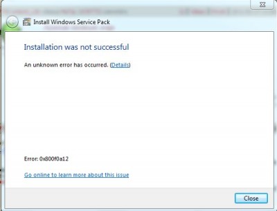

moonman
#39785
Nincs semmi állítva rajta, szabvány konfig, 100megás boot partíció, 100 gigás win7 partíció, a maradék 400GB meg adatok.
De a telepítő tényleg feldobhatta volna, hogy hé srác, valami nem oké a boot cuccoddal, katt ide és helyrerugom.. na mindegy.
Köszi a log-os tippet, eddig is nézegettem csak nem szúrtam ki a gondot. -
kraftxld
moonman
#39781
Kb ennyi a lényeg, még nem mélyedtem bele:
2011-02-17 23:15:05, Info CBS SPI: Driver directory C:\Windows\System32\DriverStore\FileRepository\atiilhag.inf_amd64_neutral_951c1812f542740a exists
2011-02-17 23:15:05, Info CBS SPI: Calling bcd edit with path "C:\Windows\System32\bcdedit.exe"
2011-02-17 23:15:05, Error CBS SPI: (CSPInstall::AutoMountDisableCheck:1026)Bcdedit failed with error code 0x1 hr=0x800f0a12
2011-02-17 23:15:05, Error CBS SPI: (CSPInstall::CompatibilityApplicabilityScan:1471)AutoMountDisable check failed hr=0x800f0a12
2011-02-17 23:15:06, Info CBS SPI: Ending Compatibility\Applicability scan
2011-02-17 23:15:06, Error CBS SPI: (PerformSPInstallation:833)Failed to install SP using UI hr=0x800f0a12
2011-02-17 23:15:06, Error CBS SPI: (wmain:1105)Failed to perform SP installation hr=0x800f0a12
2011-02-17 23:15:06, Info CBS SPI: Reporting Failed event
2011-02-17 23:22:03, Info CBS SPI: SPInstall terminating, return code 0x800f0a12
2011-02-17 23:22:03, Error CBS SPI: (SPIRegQueryStringValue:700)Failed to query registry value: MiscString2 er=0x2
2011-02-17 23:22:03, Error CBS SPI: (CSystem::GetMachineName:395)Failed to query machine name from RAC hr=0x80070002
2011-02-17 23:22:04, Info CBS SPI: Deleting directory: C:\79baddc6efe217f11dc6\12427027c214ec4f2361c7. ret=2
2011-02-17 23:25:06, Info CBS Reboot mark refs incremented to: 1
2011-02-17 23:25:06, Info CBS Scavenge: Starts
2011-02-17 23:25:06, Info CSI 00000009@2011/2/17:10:25:06.031 CSI Transaction @0x2b0ddb0 initialized for deployment engine {d16d444c-56d8-11d5-882d-0080c847b195} with flags 00000002 and client id [10]"TI6.0_0:0/"
2011-02-17 23:25:06, Info CBS Scavenge: Begin CSI Store
2011-02-17 23:25:06, Info CSI 0000000a Performing 1 operations; 1 are not lock/unlock and follow:
Scavenge (8): flags: 00000017
2011-02-17 23:25:06, Info CSI 0000000b Store coherency cookie matches last scavenge cookie, skipping scavenge.
2011-02-17 23:25:06, Info CSI 0000000c ICSITransaction::Commit calling IStorePendingTransaction::Apply - coldpatching=FALSE applyflags=7
2011-02-17 23:25:06, Info CSI 0000000d Creating NT transaction (seq 2), objectname [6]"(null)"
2011-02-17 23:25:06, Info CSI 0000000e Created NT transaction (seq 2) result 0x00000000, handle @0x210
2011-02-17 23:25:06, Info CSI 0000000f@2011/2/17:10:25:06.481 CSI perf trace:
CSIPERF:TXCOMMIT;81098
2011-02-17 23:25:06, Info CBS Scavenge: Completed, disposition: 0X1
2011-02-17 23:25:06, Info CSI 00000010@2011/2/17:10:25:06.482 CSI Transaction @0x2b0ddb0 destroyed
2011-02-17 23:25:06, Info CBS Reboot mark refs: 0
2011-02-17 23:25:06, Info CBS Idle processing thread terminated normally
2011-02-17 23:25:06, Info CBS Ending the TrustedInstaller main loop.
2011-02-17 23:25:06, Info CBS Starting TrustedInstaller finalization.
2011-02-17 23:25:06, Info CBS Ending TrustedInstaller finalization. -
kraftxld
Én is kérdeznék.
Mivel már kint van MSDN-en meg Techneten az SP1, gondoltam felrakom. Az üzemi gépen simán felment, a sajátomon nem. Mindkettő legális angol Win7 x64, a céges enterprise, a saját ultimate.
Semmi turpisság, ilyesmi, a konfig az adataimnál.
A hibakód igen informatív: 0x800F0A12
Igen, google-t használtam pár dolgot kipróbáltam de semmi változás.
Ötletek?
