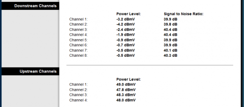

Nálam:
Upstream Channel Status
Transmitter # Channel ID Lock Status Frequency Modulation Symbol Rate Channel Type Power
1 3 Locked 46600000 64QAM 5120000 ATDMA 51.0
2 1 Locked 33200000 64QAM 5120000 ATDMA 51.0
3 2 Locked 40000000 64QAM 5120000 ATDMA 51.0
4 4 Locked 53200000 64QAM 5120000 ATDMA 51.0Downstream Channel Status
Receiver # Channel ID Lock Status Frequency Modulation Symbol Rate SNR Power
1 8 Locked 410000000 256QAM 6952000 38.6 10.7
2 1 Locked 354000000 256QAM 6952000 38.5 10.0
3 2 Locked 362000000 256QAM 6952000 38.6 10.2
4 3 Locked 370000000 256QAM 6952000 38.3 10.6
5 4 Locked 378000000 256QAM 6952000 38.6 10.9
6 5 Locked 386000000 256QAM 6952000 38.9 11.2
7 6 Locked 394000000 256QAM 6952000 38.4 11.0
8 7 Locked 402000000 256QAM 6952000 38.5 10.8 -

Nálam jelenlegi ez a helyzet:
Downstream Channels
Power Level: Signal to Noise Ratio:
Channel 1: 4.1 dBmV 41.9 dB
Channel 2: 5.3 dBmV 42.5 dB
Channel 3: 5.4 dBmV 42.5 dB
Channel 4: 5.4 dBmV 42.4 dB
Channel 5: 4.6 dBmV 41.6 dB
Channel 6: 3.6 dBmV 41.9 dB
Channel 7: 3.7 dBmV 41.4 dB
Channel 8: 3.3 dBmV 41.5 dB
Upstream Channels
Power Level:
Channel 1: 47.7 dBmV
Channel 2: 46.9 dBmV
Channel 3: 47.2 dBmV
Channel 4: 47.7 dBmV -

Nálam(Kerepes):
Up:
1 13 Locked 33200000 64QAM 5120000 ATDMA 49.50 dBmV
2 14 Locked 40000000 64QAM 5120000 ATDMA 50.25 dBmV
3 15 Locked 46600000 64QAM 5120000 ATDMA 50.00 dBmV
4 16 Locked 53200000 64QAM 5120000 ATDMA 50.75 dBmVDown:
1 20 Locked 410000000 256 QAM 6952000 36.844 dB 3.33 dBmV
2 21 Locked 418000000 256 QAM 6952000 36.387 dB 2.88 dBmV
3 22 Locked 426000000 256 QAM 6952000 36.610 dB 2.96 dBmV
4 23 Locked 434000000 256 QAM 6952000 36.387 dB 2.54 dBmV
5 24 Locked 442000000 256 QAM 6952000 36.844 dB 2.73 dBmV
6 29 Locked 450000000 256 QAM 6952000 37.093 dB 3.21 dBmV
7 30 Locked 458000000 256 QAM 6952000 37.093 dB 3.39 dBmV
8 31 Locked 466000000 256 QAM 6952000 37.093 dB 3.15 dBmV -

2589 2015-08-12 14:05:04 -5.7 -7.0 -6.3 -6.5 -5.9 -6.3 -5.6 -7.5 51.5 53.0 0.0 0.0
2590 2015-08-12 14:10:04 -6.0 -7.2 -6.6 -6.8 -6.2 -6.5 -5.9 -7.9 51.5 53.0 0.0 0.0 -
#99546112
1 1 Zárolva 33200000 64QAM 5120000 ATDMA 51.0
2 2 Zárolva 40000000 64QAM 5120000 ATDMA 51.0
3 3 Zárolva 46600000 64QAM 5120000 ATDMA 51.0
4 4 Zárolva 53200000 64QAM 5120000 ATDMA 51.01 1 Zárolva 354000000 256QAM 6952000 41.2 -6.0
2 2 Zárolva 362000000 256QAM 6952000 40.9 -6.0
3 3 Zárolva 370000000 256QAM 6952000 40.8 -6.1
4 4 Zárolva 378000000 256QAM 6952000 40.3 -6.7
5 5 Zárolva 386000000 256QAM 6952000 40.8 -6.2
6 6 Zárolva 394000000 256QAM 6952000 40.4 -6.6
7 7 Zárolva 402000000 256QAM 6952000 40.4 -6.5
8 8 Zárolva 410000000 256QAM 6952000 40.7 -6.1Ezek az értékek.

Tetőtér 35 fok, forró az "ubi".
1 11 Locked 59800000 64QAM 5120000 ATDMA 48.25 dBmV
2 7 Locked 33200000 64QAM 5120000 ATDMA 48.50 dBmV
3 8 Locked 40000000 64QAM 5120000 ATDMA 49.75 dBmV
4 9 Locked 46600000 64QAM 5120000 ATDMA 49.25 dBmVHajnalra 47.5 körül lesz, ez normális?
Ez meg szinte nem is változik:
1 18 Locked 450000000 256 QAM 6952000 38.258 dB 3.95 dBmV
2 13 Locked 410000000 256 QAM 6952000 37.636 dB 3.67 dBmV
3 14 Locked 418000000 256 QAM 6952000 37.636 dB 3.66 dBmV
4 15 Locked 426000000 256 QAM 6952000 37.936 dB 3.73 dBmV
5 16 Locked 434000000 256 QAM 6952000 38.983 dB 4.07 dBmV
6 17 Locked 442000000 256 QAM 6952000 38.605 dB 4.07 dBmV
7 19 Locked 458000000 256 QAM 6952000 38.605 dB 3.85 dBmV
8 20 Locked 466000000 256 QAM 6952000 38.258 dB 3.61 dBmV -

Downstream Channels
Channel 1: 9.2 dBmV 39.9 dB
Channel 2: 3.5 dBmV 37.2 dB
Channel 3: 4.7 dBmV 37.8 dB
Channel 4: 6.2 dBmV 37.8 dB
Channel 5: 7.8 dBmV 39.4 dB
Channel 6: 8.4 dBmV 39.9 dB
Channel 7: 8.9 dBmV 40.3 dB
Channel 8: 3.4 dBmV 37.5 dBUpstream Channels
Power Level:
Channel 1: 43.3 dBmV
Channel 2: 42.2 dBmV
Channel 3: 44.0 dBmV
Channel 4: 42.0 dBmV -

kabelmania27
tomp
kabelmania27 #39100 üzenetére
Nemrég ment el a technikus. Nagyon kedves volt. Mesélte, hogy ez a meleg jól megizzasztja a hálózatot.
Sok embernél a házilag megbarkácsolt hálózat mondja be az unalmast a nagy melegben.
Kicserélte a tv ág végén lévő olcsó műanyag csatlakozót a upc-nél használatos fémre. A kábel maradt. Minden más maradt mert a kábelt jó minőségűnek ítélte.
Már ezzel is javult de még nem volt az igazi. Rámért többször is a jelre mert 112MHz előtt tüskés volt erősen. Aztán megnézte a lakásba bejövő kábelt is. Az ajtónál van a toltás. Azt megfogva majdnem szét is jött.Talán 1tekerésnyi menet tartotta össze. A lakáshoz jövő kábelben tökéletes a jel. Összerakta, jól meghúzta majd a tv-nél is megmérte. Tökéletes.
Tv-be kábelt be az rtl klub hd-ra raktam azaz 112MHz-re, páramentesítő megy és a jelminőség 100%.Modem értékek is változtak:
Downstream Channels
Channel 1: 2.0 dBmV 40.0 dB
Channel 2: 2.7 dBmV 40.8 dB
Channel 3: 2.8 dBmV 40.8 dB
Channel 4: 2.8 dBmV 40.8 dB
Channel 5: 2.5 dBmV 40.1 dB
Channel 6: 2.0 dBmV 40.4 dB
Channel 7: 1.9 dBmV 40.1 dB
Channel 8: 1.8 dBmV 40.3 dBUpstream Channels
Power Level:
Channel 1: 41.5 dBmV
Channel 2: 41.2 dBmV
Channel 3: 40.9 dBmV
Channel 4: 41.7 dBmV -
