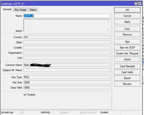

Google az én barátom ezt mondta, kivastagítottam a lényeget:
Error Code: 0x800B010F
Table 15
Error Description: 0x800B010F: The certificate's CN name does not match the passed value.
Possible Cause: This issue may occur if the host name of the server that is specified in the VPN connection does not match the subject name that is specified on the SSL certificate that the server submits to the client computer.
Possible Solution: Verify that the certificate which RAS server uses for SSL has the correct subject name. For example, if the VPN client is configured to use FQDN name to connect to the VPN server, the certificate used by VPN server must have FQDN in the subject name. Same thing if the client is configured to use IP address (IPv4 or IPv6) of VPN server. If the appropriately-named certificate is not present on the RAS server, you must obtain a new certificate for the RAS server.
For changing the SSTP machine certificate, please refer to this blog if on VPN server is running Windows server 2008 R2, else refer to this blog -
