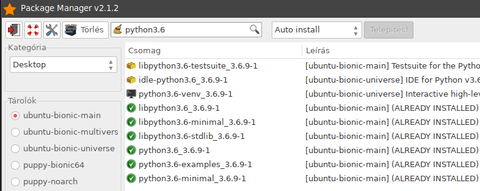

brazos #37967 üzenetére
Hát ez se mai python, de felraktam a kedvedért egy bionic ubuntut és egy 3.6-os pythont, nekem volt ilyen függvény:
main.py
import datetime
print(datetime.datetime.fromisoformat.__doc__)
$ python3.6 main.py
string -> datetime from datetime.isoformat() output
De akkor kitalálok valamit helyette. -

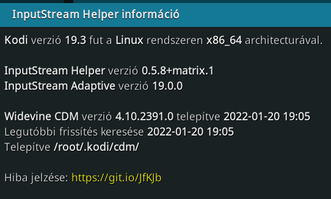

64 bites Kodi-19.3 alatt sem jó!
ez a hibaüzi:
2022-01-20 18:53:46.728 T:9063 ERROR <general>: EXCEPTION Thrown (PythonToCppException) : -->Python callback/script returned the following error<--
- NOTE: IGNORING THIS CAN LEAD TO MEMORY LEAKS!
Error Type: <class 'AttributeError'>
Error Contents: type object 'datetime.datetime' has no attribute 'fromisoformat'
Traceback (most recent call last):
File "/root/.kodi/addons/plugin.video.mindigo/default.py", line 230, in <module>
live_window()
File "/root/.kodi/addons/plugin.video.mindigo/default.py", line 136, in live_window
create_epg_guide(all_channels, epg)
File "/root/.kodi/addons/plugin.video.mindigo/default.py", line 125, in create_epg_guide
epg_transform.write_str(__addondir__, 'mindigo_xmltv.xml', epg_transform.make_xml_guide(channels, epg))
File "/root/.kodi/addons/plugin.video.mindigo/epg_transform.py", line 29, in make_xml_guide
start = datetime.fromisoformat(program["startTime"].replace('Z',' +00:00')).strftime("%Y%m%d%H%M%S +0000")
AttributeError: type object 'datetime.datetime' has no attribute 'fromisoformat'
-->End of Python script error report<--
2022-01-20 18:53:46.737 T:5237 INFO <general>: CActiveAESink::OpenSink - initialize sink
2022-01-20 18:53:46.737 T:5237 INFO <general>: CAESinkALSA::Initialize - Attempting to open device "@"
2022-01-20 18:53:46.750 T:5237 INFO <general>: CAESinkALSA::Initialize - Opened device "sysdefault"
2022-01-20 18:53:46.758 T:5237 INFO <general>: CAESinkALSA::InitializeHW - Your hardware does not support AE_FMT_FLOAT, trying other formats
2022-01-20 18:53:46.758 T:5237 INFO <general>: CAESinkALSA::InitializeHW - Using data format AE_FMT_S32NE
2022-01-20 18:53:47.216 T:9063 INFO <general>: Python interpreter stopped
2022-01-20 18:53:47.235 T:9061 ERROR <general>: GetDirectory - Error getting plugin://plugin.video.mindigo/?action=channels&fanart=%2froot%2f.kodi%2faddons%2fplugin.video.mindigo%2ffanart.png&icon=https%3a%2f%2fi.imgur.com%2fn0AbCQn.png&name=%c3%89l%c5%91%20Csatornak%c3%adn%c3%a1lat
2022-01-20 18:53:47.236 T:5033 ERROR <general>: CGUIMediaWindow::GetDirectory(plugin://plugin.video.mindigo/?action=channels&fanart=%2froot%2f.kodi%2faddons%2fplugin.video.mindigo%2ffanart.png&icon=https%3a%2f%2fi.imgur.com%2fn0AbCQn.png&name=%c3%89l%c5%91%20Csatornak%c3%adn%c3%a1lat) failed -

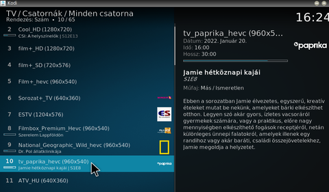

Egyszerűen, kézzel, sk. Felmész az onlinestream.hu oldalra, és ott a tv-s oldalra, majd minden egyes tv adónak lemented az adó m3u fájlját, és azokból gyártasz egy teljes, saját iptv m3u fájlt, ami beadsz a PVR IPTV Simple Client addonba, és akkor a Kodi tv részénél meg fognak jelenni sorban az egyes adók. Azt azért nem árt tudni, hogy a Kodi nem mindegyik ilyen tv adó m3u-s linkjét eszi meg, így lesznek olyanok is a nagy közös listában, ami nem fognak elindulni, és ott meg fog állni a Kodi-ban a lejátszás, vagy rosszabb esetben megfagy a kodi, és csak újraindítás segít rajta.
A PVR IPTV Simple Client addon használatát a neten megtalálod.
kb. így fog kinézni az eredmény: -
