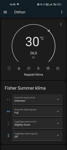

Nézd meg hogy tuya, smart life appal megy-e a klíma
Lehet hogy ez a nethome plus is tuya alapúEzt találtam még
Finally i did it my friends. Very easy, from HACS install MIDEA AC LAN.
Then go to Integrations and add the MIDEA AC LAN, it will ask if you want to do the configuration manually or automatically, Turn ON the AC and choose Automatically and it will find your AC very fast. -
