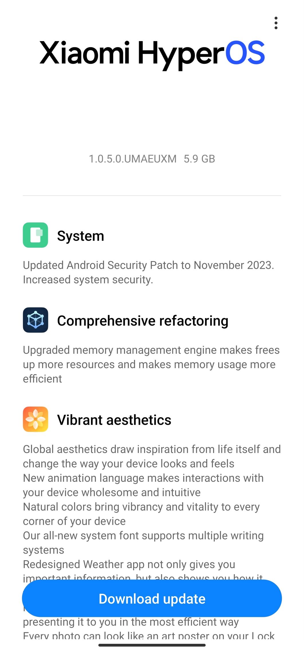

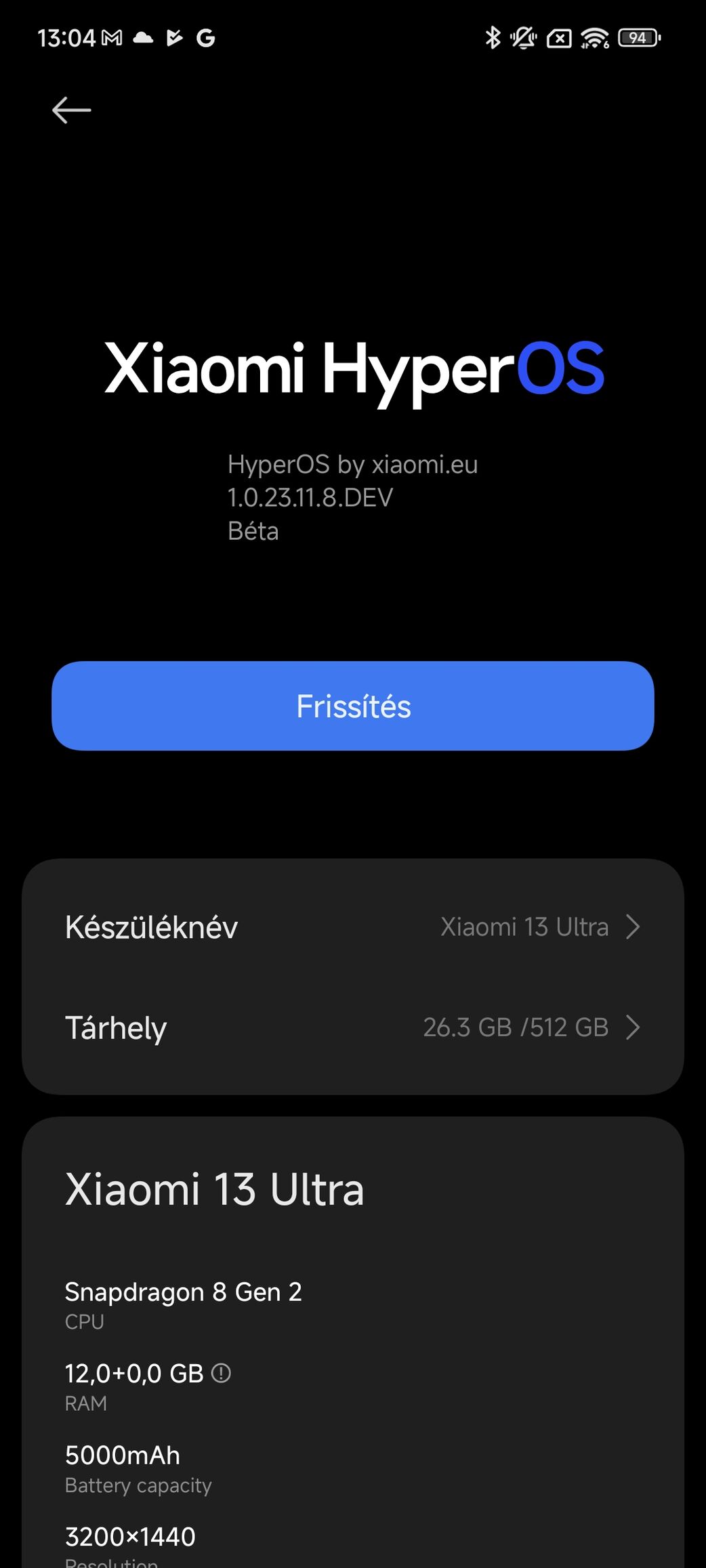

Kijött a legújabb dev HyperOS [ 23.11.27]
CHANGELOG
System
Fix - When opening the power menu and turning off the screen, it remained on the screen when turning the screen on
Fix - Tapping the weather widget in notification center opened both Weather and Calendar apps when using old Control center style
Fix - Brightness bar was not working well in the old Control center style
Fix - Brightness and volume bars in Control center were missing in some third-party styles
Fix - Animation stuck when switching between Control center and Notification shade
Lock screen
Fix - System UI crashed when a side panel shortcut was being tapped
Home screen
Fix - Abnormal enlargement of app icons when opening them in different scenarios
Status bar
Fix - Sometimes notification icons appeared in color
Fix - the issue where the Amap taxi icon in the status bar could not be cleared
Floating windows
Fix - Black screen after opening floating window in some scenes
Camera
Fix - "Shutter sound" toggle was missing in settings [Camera app versions 5.1.x only]
If you will have some apps crashing after update (it is random issue, therefore OTA is not pushed), run these adb commands via PC
Code:adb shellpm compile -a -f -r cmdlinepm compile -f -r cmdline --secondary-dex com.google.android.gmsexit
Regarding Google Pay
We have implemented our own solution how to update fix in case Google BAN it again, without rebuilding whole ROM or using ROOT/Magisk
This ROM version already includes our GPay fix
If GPay doesnt work for you on this ROM version, install this apk manuallyHyper OS telepítése a készülékre nyitott bootloaderrel
Installing with Fastboot:
Download Xiaomi.eu ROM zip file
Extract the ROM zip to a new folder
Power off your device Boot your device in Fastboot mode (Hold volume down + power buttons)
Connect to PC via USB cable Run one of the installation scripts (according to your PC operating system):
- first_install_with_data_format - with data wipe, if you're flashing Xiaomi.eu ROM for the first time or downgrading.
- update_rom - without data wipe, if you're updating from an older Xiaomi.eu ROM. Done!Magyarul:

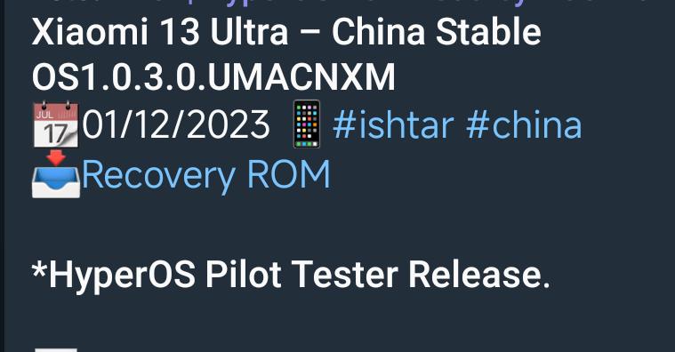

Bár itt nincs Pilot Tester, de kijött az első stabil china alapokon
Magyarán, aki Pilot Testernek jelentkezett, az tudja telepíteni. -
