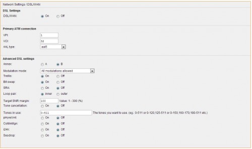

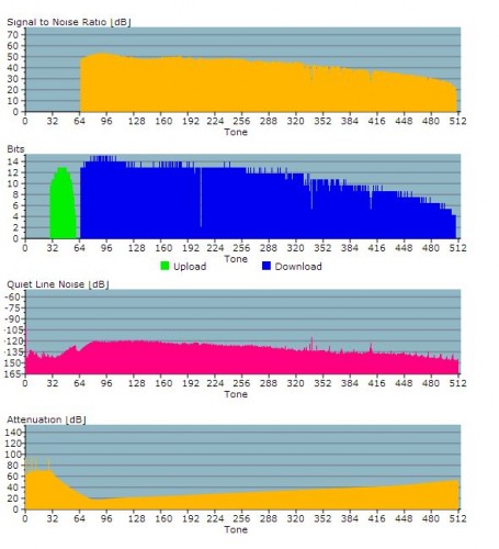

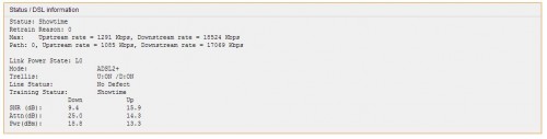

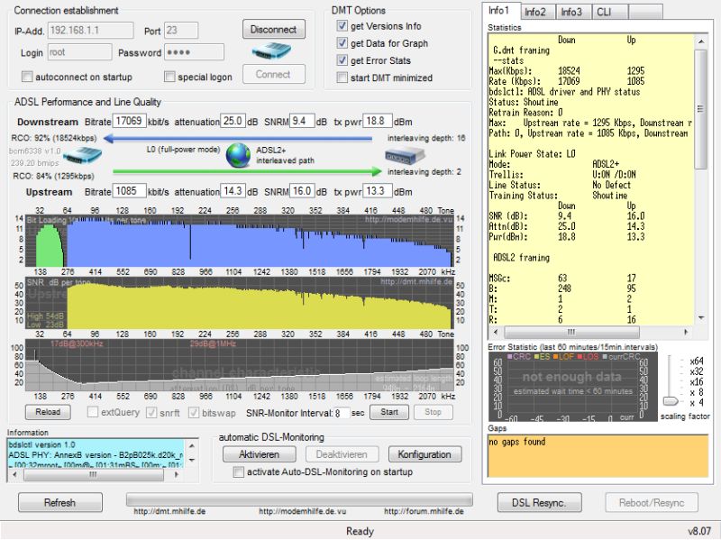

Közben sikeresen elkészítettem a spektrumképeket a vonalamról.
Első körben egy kis adat:
Down Up
G.dmt framing
--stats
Max(Kbps): 18524 1295
Rate (Kbps): 17069 1085
bdslctl: ADSL driver and PHY status
Status: Showtime
Retrain Reason: 0
Max: Upstream rate = 1295 Kbps, Downstream rate = 18524 Kbps
Path: 0, Upstream rate = 1085 Kbps, Downstream rate = 17069 KbpsLink Power State: L0
Mode: ADSL2+
Trellis: UN /D
N
Line Status: No Defect
Training Status: Showtime
Down Up
SNR (dB): 9.4 16.0
Attn(dB): 25.0 14.3
Pwr(dBm): 18.8 13.3ADSL2 framing
MSGc: 63 17
B: 248 95
M: 1 2
T: 2 1
R: 6 16
S: 0.4658 5.6026
L: 4379 297
D: 16 2Counters
SF: 5429 5442
SFErr: 1 0
RS: 749228 62088
RSCorr: 11 0
RSUnCorr: 15 0HEC: 1 0
OCD: 0 0
LCD: 0 0
Total Cells: 3506282 730722056
Data Cells: 0 3271931494
Drop Cells: 0
Bit Errors: 0 318576ES: 1 3281
SES: 0 28
UAS: 19 961514
AS: 87INP: 0.08 0.43
PER: 16.07 16.10
delay: 1.86 2.80
OR: 34.34 11.42Bitswap: 15 1
És a spektrumképek:
Vélemény?
