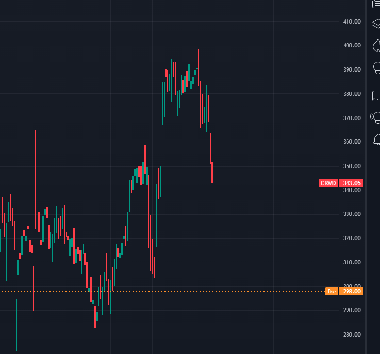

már -20%-ban a pre market

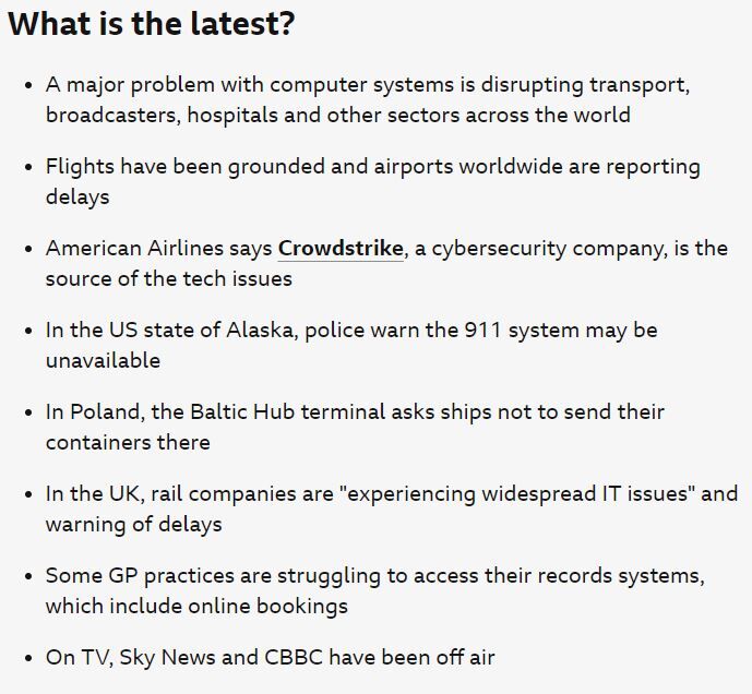

There have been reports suggesting that a cybersecurity company called Crowdstrike, which produces antivirus software, issued a software update that has gone horribly wrong and is bricking Windows devices - prompting the so-called "blue screen of death" on PCs.
Now, whether these two issues are the same thing, or whether it's a perfect storm of two big things happening simultaneously - I don't yet know. It certainly sounds like it's going to be causing a lot of havoc.
We've contacted Crowdstrike for response but haven't heard back yet.
Úgy tűnik a Crowdstrike-nál van probléma.
