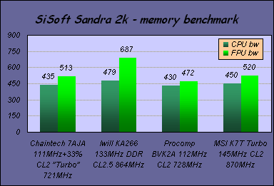

Here it is: the good ol' SiSoft Sandra 2000 memory benchmarks. Instead of measuring Quake3 FPS results, which tell us a lot about our video card, we voted for Sandra. Besides general CPU stability, memory stability and performance is a key differentiator amongst motherboards. A well-built board should perform well and be able to run the memory at the most agressive timings at high FSBs. The K7T Turbo-R excelled in all these areas, if you don't believe us, check out the diagram below. MSI's offering only falls short of the Iwill KA266 DDR mainboard, but that shouldn't suprise us. The difference in performance is far less however, than the difference in the prices.
