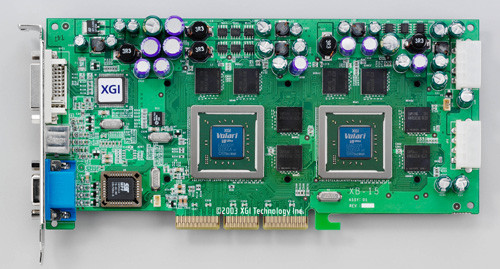

PH!: would you please explain your multi-chip technology called BitFluent? It seems there should be some sort of order between GPUs, at least at display data path. What about at rendering level, how do you allocate rendering jobs between GPUs?
XGI: For a more in-depth information, you check check on XGITech.com under the product section, there shall be a white paper explaining clearly how it works. Simply put, the two GPU works as follows: The master GPU is connected to the AGP interface and the Slave GPU is connected to the master GPU. Each of the two GPUs has its own local frame buffer, which is what we called DRAM. Basically, the master GPU will process frame 1, 3, 5, ... and slave GPU will process frame 2, 4, 6, ... and so on.
From our studies, this is the most efficient way of putting two GPUs together. The overall efficiency is about 1.7* the performance of one GPU.
XGI Volari V8 Duo
PH!: still BitFluent: how is the GPU's memory access? Each GPU has its own memory area or they can see each others'?
XGI: That's correct, each has one set of a 128 bit wide, indepedent memory bus that it can access for highest efficiency.

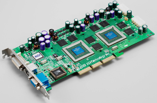

PH!: important question: how much power is needed for these chips? How much is the typical power consumption of the dual-GPU chip/board? Is there an external power connector like on high-end Radeon and Geforce FX cards?
XGI: The typical power consumption is about 70W. Actually there are two external power plugs needed for this board. This is to push the revolutionary 16 pipeline architecture.
