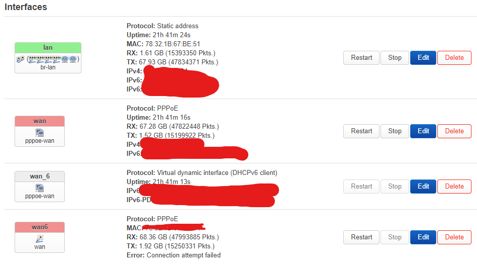

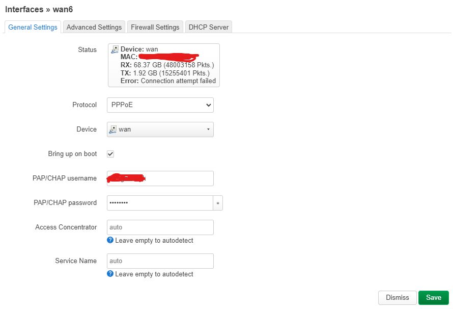

Gigabitet ír mindenhol, minden stimmel, a másik routerrel is ment minden.
OpenWrt logban ennyi van:
Fri Dec 8 10:13:55 2023 daemon.notice netifd: Interface 'wan6' is setting up now
Fri Dec 8 10:13:55 2023 daemon.info pppd[10570]: Plugin pppoe.so loaded.
Fri Dec 8 10:13:55 2023 daemon.info pppd[10570]: PPPoE plugin from pppd 2.4.9
Fri Dec 8 10:13:56 2023 daemon.notice pppd[10570]: pppd 2.4.9 started by root, uid 0
Fri Dec 8 10:14:11 2023 daemon.warn pppd[10570]: Timeout waiting for PADO packets
Fri Dec 8 10:14:11 2023 daemon.err pppd[10570]: Unable to complete PPPoE Discovery
Fri Dec 8 10:14:11 2023 daemon.info pppd[10570]: Exit.
Fri Dec 8 10:14:11 2023 daemon.notice netifd: Interface 'wan6' is now downNalam igy nez ki:
Vezetekes Speedtest:
Speedtest by OoklaServer: OPC NETWORKS Kft. - Budapest (id: 22794)ISP: Digi TVIdle Latency: 2.91 ms (jitter: 0.38ms, low: 2.74ms, high: 4.09ms)Download: 924.24 Mbps (data used: 474.1 MB)4.67 ms (jitter: 0.66ms, low: 2.57ms, high: 11.12ms)Upload: 319.86 Mbps (data used: 143.9 MB)5.75 ms (jitter: 1.05ms, low: 3.66ms, high: 8.53ms)Packet Loss: 0.0%A /etc/config/network idevago resze (a "debug" meg a "80 20" csak az en hulyesegem, nem szamit a sebessegben):
config deviceoption name 'wan'config interface 'wan'option device 'wan'option proto 'pppoe'option username 'DIGI username'option password 'DIGI password'option keepalive '80 20'option pppd_options 'debug'config interface 'wan6'option device 'wan'option proto 'dhcpv6'Hardveres offload bekapcsolva - nincs extra terheles vezetekes Speedtest soran:
Mem: 122008K used, 123360K free, 4208K shrd, 0K buff, 33136K cached
CPU: 0% usr 9% sys 0% nic 90% idle 0% io 0% irq 0% sirq
Load average: 0.06 0.07 0.10 4/91 29634 -
Fri Dec 8 10:14:11 2023 daemon.notice netifd: Interface 'wan6' is now downOlyan mintha nyitni akarna a wan6 egy második PPPoE sessiont.
Én a Te képeden is látszódó wan_6 pszeudo interfacet szoktam használni a wan6 helyett, nagyjából így:
uci del_list firewall.@zone[1].network='wan6'uci add_list firewall.@zone[1].network='wan_6'uci delete network.wan6uci commit -

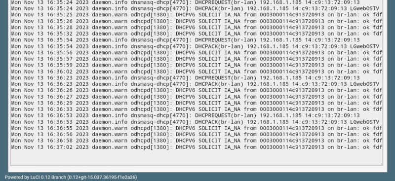

WDR3600-ra csatlakozom 2 TV-vel.(openwrt) Ment is évekig gond nélkül azonban pár hete az egyik tv percenként jelez, hogy Lan kábel lecsatlakoztatva / felcsatlakoztatva.... A másik TV megy gond nélkül.
Logban ezt találtam.
Bocs a képért, telefonról léptem be.
Ha bárkinek van ötlete szívesen fogadnám.
Köszi előre is. További szép estét Nektek.Kábel csere? Esetleg másik LAN aljzatban?
